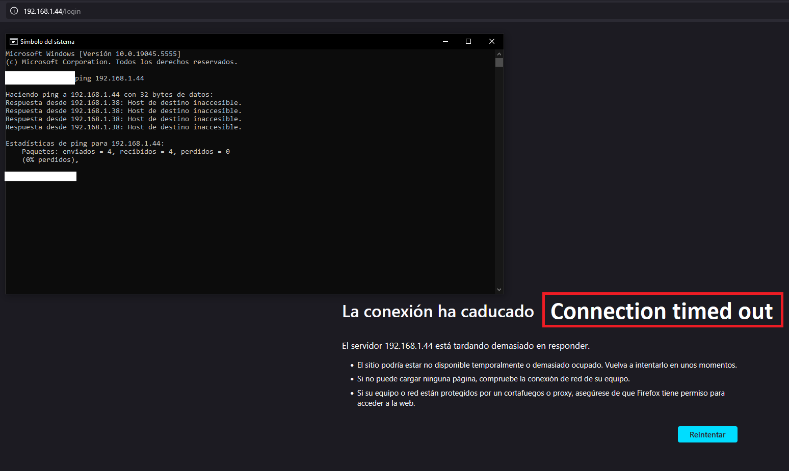

I am having issues with the NAS connectivity. When I reboot and connect to it, everything seems to work.
The next day, I try to connect and the server can't be reached. Once I reboot the server I can connect to it again. This may be related or not, but maybe it happens when I shut down the PC I use to connect to the server.
Any ideas on what might cause this? I attach the ping test when it's not working and when it works after rebooting the server. I also attach diagnostics.

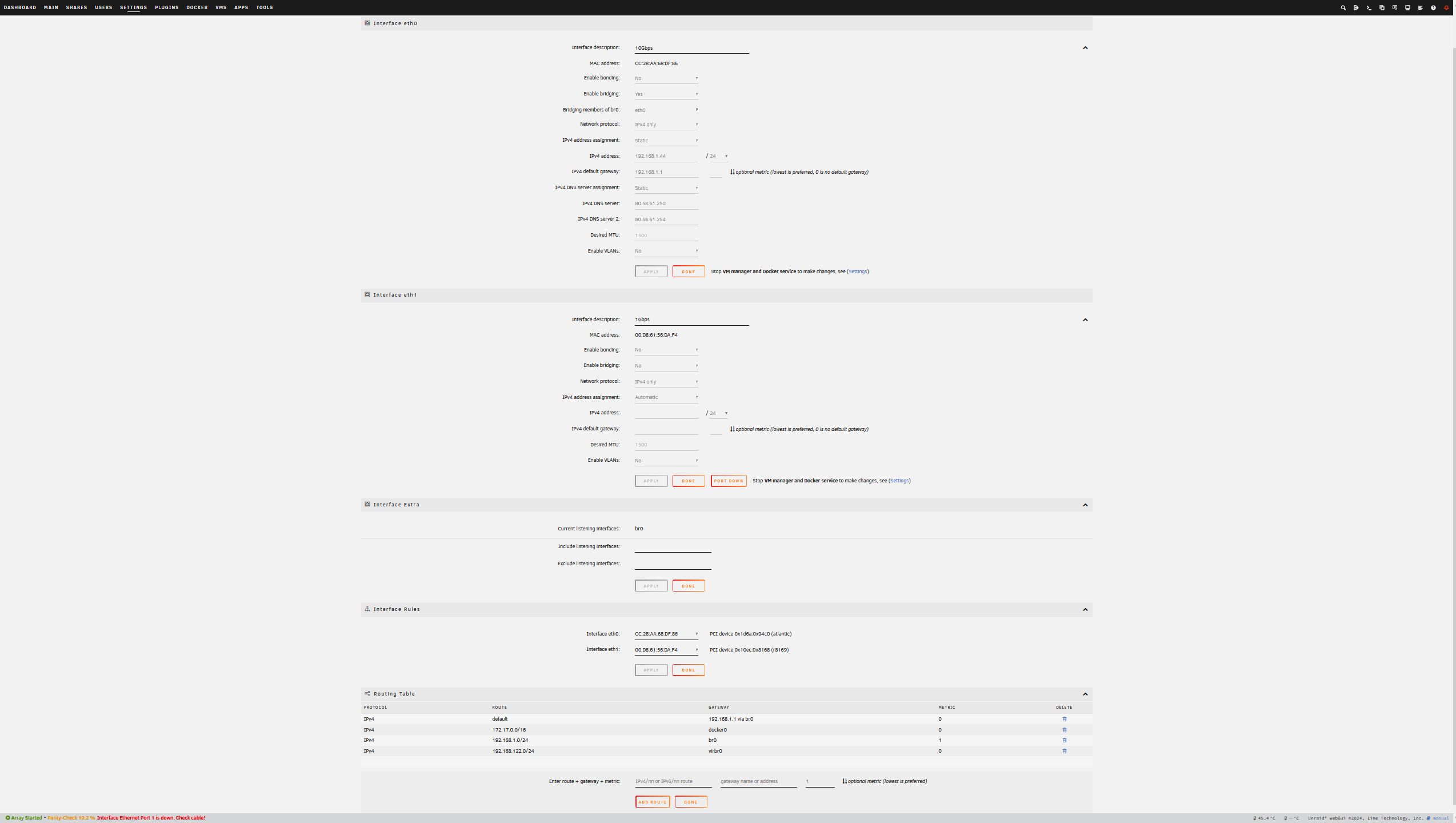

These are my settings, is there something that could be causing this? Maybe the reason it's not working properly is because of a bad config?
