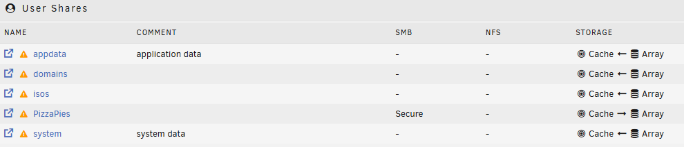

Thanks @trurl.  I've set appdata, system, and domains to Primary:cache and Secondary:array, with the move action:array-to-cache.  Invoked the mover, but it was a very quick operation.
I'm noticing the exclamation point next to all my shares now.  See pic.  Also posted new diagnostics.  Thank you taking a look!
tower-diagnostics-20250314-1146.zip
system still has files on the array. Did you go to Settings and do this

Mover won't overwrite files. If something is in both places you will have to sort that out yourself. The built-in Dynamix File Manager isn't too hard to figure out.
Or we can go to the command line.

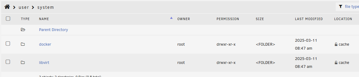

I trimmed everything using the File Manager, and attempted to make cache the source of truth for everything except for my disk array share (PizzaPies).  So, I've got my disk shares in green, but appdata, domains, isos, and system are still in the orange exclamation mark.  System seems only to appear on cache--I spot checked the other drives, and there is no system folder on the disks in the array.

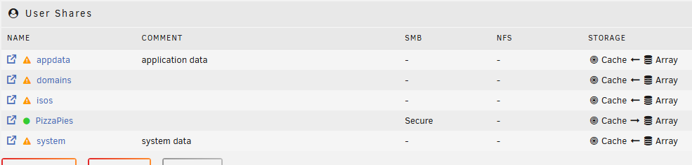

The remaining user shares look like:
Might be worth noting that I don't have any domain or isos folders.  Appdata and system are located on cache and no other disk.
Performed a reboot and logged new diagnostics.
It seems to me like the original issue is now cleared up, but do you see any other issues remaining with the shares?
tower-diagnostics-20250314-2206.zip
appdata                           shareUseCache="prefer"  # Share exists on cache
domains                           shareUseCache="prefer"  # Share exists on cache
isos                              shareUseCache="prefer"  # Share exists on cache
P-------s                         shareUseCache="yes"     # Share exists on disk2, disk3, disk4, disk5, disk6
system                            shareUseCache="prefer"  # Share exists on cache
All on cache that should be kept on cache.
This just means the shares have some files/folders that are not on redundant storage. You would have to have cache pool mirror for example to make that go away. Since you aren't doing VMs the main thing is to keep a backup of appdata. There is a plugin for that.

According to that User Shares screenshot you do. Diagnostics says they are on cache. Might be empty folders.
You should set Minimum Free for cache
https://docs.unraid.net/unraid-os/manual/storage-management/#minimum-free-space-for-a-pool
Minimum Free for each User Share looks like they were auto-set. That may be larger than necessary but should be OK.
https://docs.unraid.net/unraid-os/manual/shares/user-shares/#minimum-free-space
Yes, just empty folders.
Good advice, thank you!  I do use this cache pool for a lot of media and temp storage before migrating to the array.  Ideally, I'd have a separate cache pool for this, and I'll open up a separate thread to ask about that.
That's fine. You can delete them or not. If you ever enable VM Manager, those will get created anyway.
