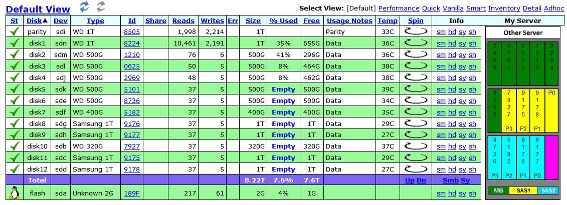

The trouble began when I added two new Supermicro cages and tried to add eight new disks. I immediately had trouble, so I booted up with only the six disks from before. Great, one disk is disabled. I tried to swap one of the about to be added disks for the newly disabled disk, and it displayed as a 1TB disk, not 500GB. Okey, dokey. I finally swapped in one of the new 1TB disks (*9176), and the rebuild took place today.
Current issues:

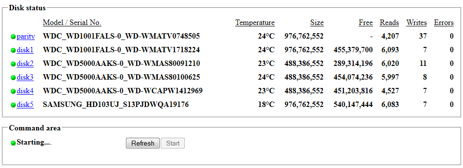

You can see in the screen shot, none of the Command Area buttons are there. Bummer.
My one and only share is gone, and has been gone since the first time I tried to boot up with all eight new disks active.
disk5 does not let me into view the contents. Windows Explorer, Total Commander, Midnight Commander, unRAID file browser, etc. None will allow me access to the disk's contents.
Things look stable now, but I'd like to perform a simple reboot to see if the share comes back. Possibly related to these hard shutdowns that are continuing is the attempt to access disk that is filling up the memory. You can see in the attachment where invoking powerdown simply fails.
I'm REALLY frustrated here, and I'm hoping someone can ask the correct questions to get me in the right direction to solve this. Also, a better subject line to help someone else?

That's all I have for a syslog. After the last boot, I took the screenshot, tried to access disk5 directly, the web interface stopped responding, and I had to do a hard shutdown. The server is off for now.
Only one of the new cages has active disks in it at this point, although the bottom one does have power so its fan runs.

Command Area buttons did not return. Could not access disk5 directly. New syslog taken before the web interface crashed.

All disks are currently connected to the motherboard, no MV8 in use. I think the errors you see are from after it was not in use.
I pulled disk5 from its cage, and am booting up.
Command area is back without disk5 attached. Running initconfig...
What about the data that's on disk5? Will it be recoverable at some point?
I was hoping you'd try each line at a time. It would be possible to rebuild disk5 if the data on disk5 could be simulated by starting the array without it. Then, you'd just be trying a new drive connected to a new port for the rebuild. If this test had failed then the disk can not be rebuilt so that's the point where you abandon it and try to recover the data off the disk later.

Although the server is once again stable and I'm adding disks to it, I think I figured out the root of the issue. One of the 3WARE Cable Multi-lane Internal Cable (SFF-8087) sets would seat, but not LOCK into the Supermicro card. I tried both cables in both positions. Only one will lock, and it locks into both. The (likely) defective cable was connected to every disk that I was having trouble with.
That cable was attached to the slots shown as SAS1.
The replacement order is already started with amazon. It is estimated to deliver tomorrow.
New cable arrived, and it LOCKS into the card as it should!
