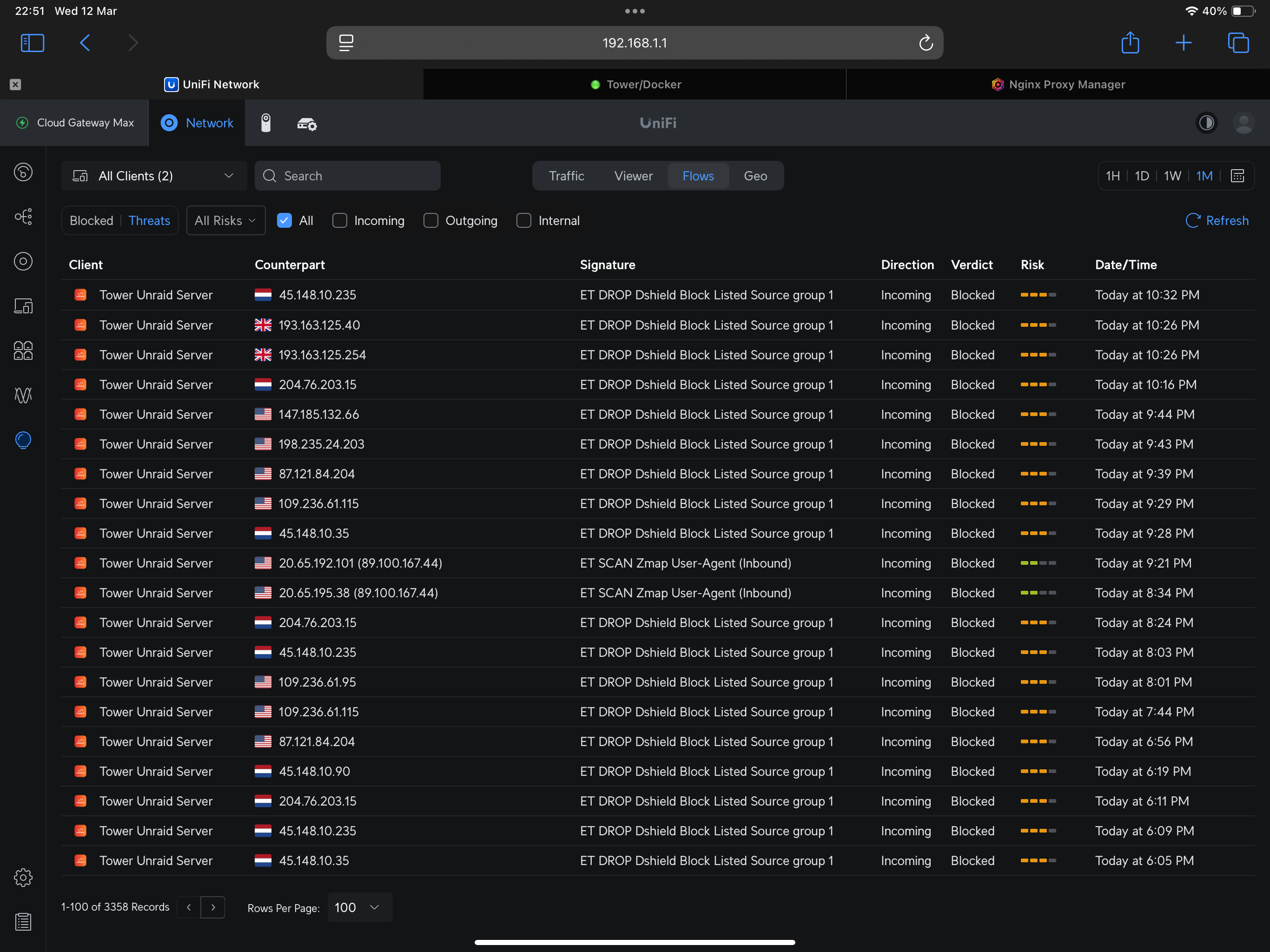

Second question is regarding some attacks I can see on my UniFi network, All directed at my Unraid server. See Pic attached. I know they are getting blocked but I am curios on what they are and if it is because I use NGINX Proxy.
I didn't notice any suspicious IPs in syslog.
