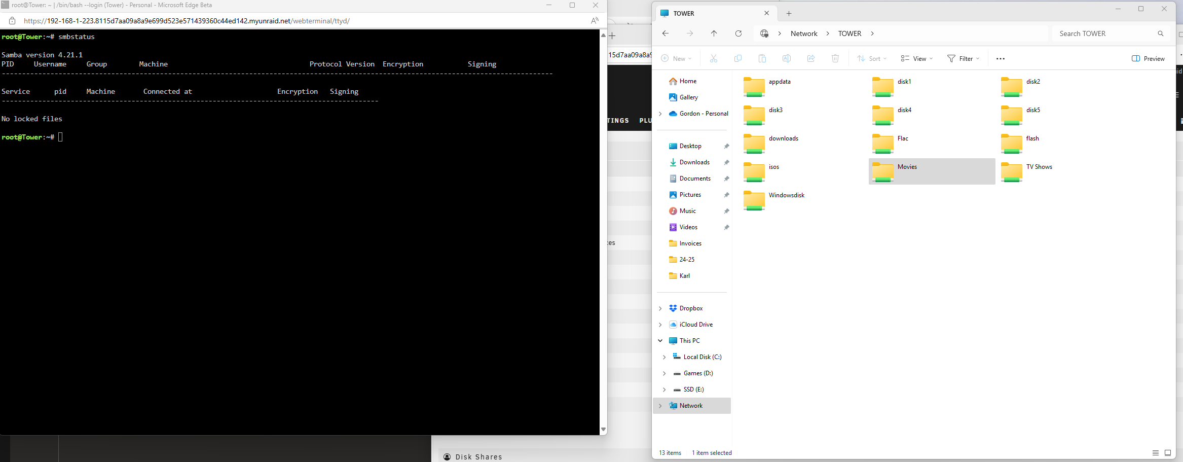

Thank you for you reply.  I have a login for windows I can see the shares but when I try to open them its asks for my credentials then says access denied when entered.  update I can open the movie folder when share changed to public.  But cant open it on the R video application in window or on the player its self.

Do you have a Share Access user   (USERS  >>>   Shares Access) set up on Unraid with a user name of 'media' and the password that you are using in the video?  Ideally, you should also have a Windows credential setup using Windows Credential Manager for the user 'media'.

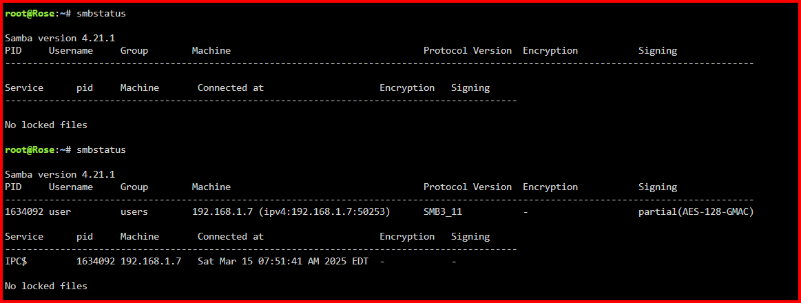

This is what the output of smbstatus is for one of my servers:
The first time I ran it, I had not 'looked' at the server after starting my PC.  For the second time, I had just opened the server to see the shares.  As you can see from this instance, a user named 'user' (perhaps, a bad choice for a user name...) is present using Samba services.

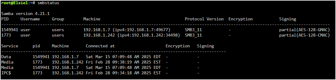

Now for the second server:
When I start my PC, it automatically opens up two mapped drives to shares (Media and Data) on this server.  While both shares are set to private, when the PC was started this morning, Windows Credential manager automatically logged on my PC to the server and Windows could then mapped the drives.   (The second smb login from 192.168.1.242 is the other server accessing this server using Unassigned Devices.  As you can see that connection has been up for fifteen days.)
You do realize that Windows will allow only one connection to any server.  (The corporate and government world insisted on this restriction for security reasons.)  If you attempt to log onto the same server with a second user name, Windows will throw up an error message that provides no clue as to what the problem is.  Unraid can contribute to this problem because it allows for silent guest access to 'Public' shares.  This 'guest' access becomes the one allowed connection!
One more thing, realize to SMB/Samba, a login (like, 'user') is nothing but a set of rules about what resources on the server can be accessed.  If a second PC wants to use that same set of rules, it can simply log into that server using that same login name.  SMB/samba tracks things by appending the client computer's LAN name to the SMB login name.  Thus when I log onto this server, my actual SMB name is  NEATH\user to the server.  If my wife was to login as 'user', her actual SMB name would   FEILER\user. (This concept of a login being a 'person' rather than a set of rules is a human 'invention'.)
