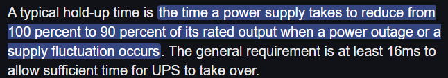

Pls note when power failure,  line-interactive type UPS will switching to and switching back, so there have two power interruption in very short time. If your PSU haven't enough hold-up time or UPS switching time too long, then problem will happen.

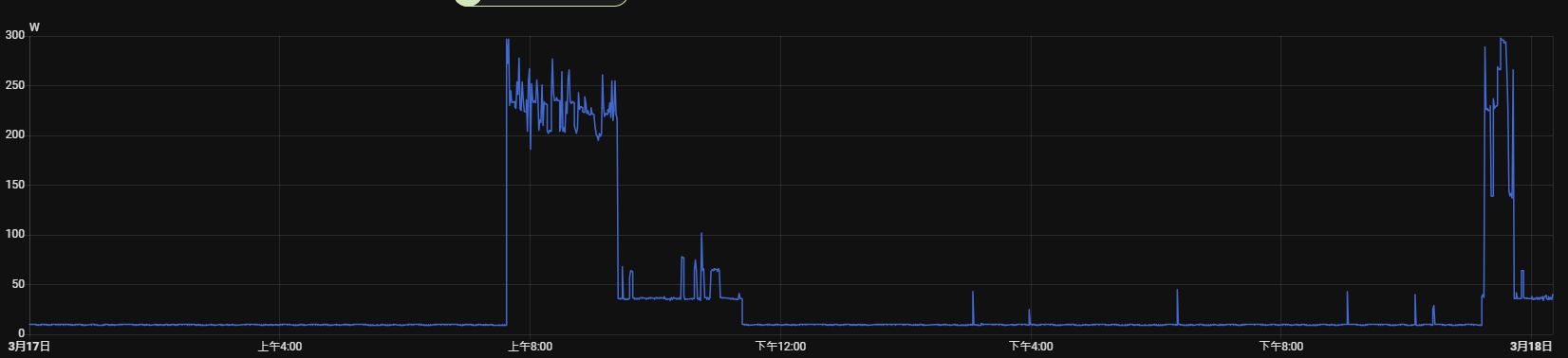

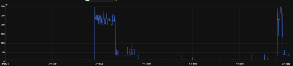

So, the best way is to test power interruption periodic, make system ( and disks ) in full load  to draw maximum power ( but don't put disk in mount state ).
Edited by Vr2Io
Do you have any recommendations on how to do this test? I'm not sure what I should be looking for either. I can switch the power off while under full load. But I already know that when I switch over I get write errors. Are you suggesting the UPS should be replaced?
1st, make system start in maintenance mode
2nd, Spindown all disks and take the minimum power usage.
image.png.aea1e8efbdbc460fd2d6885b3b7119d9.png image.png.e064b73ce788d6c8f6d527a6356c2ba7.png
3rd, Spinp all disks and take the idle power usage.
4th, Perform parity / disks check without correction
image.png.34fa5577927be136ab5ee0f5c919904a.png image.png.201beb6da71708545aa447238032db97.png image.png.83238eab4ab7071066d699df183f1764.png
5th, Your could also stress the CPU by install plugin "core-freq'" and run stress test by shortkey "O" - Atomic Burn
image.png.226076db92ce7eff0c3f24a946016969.png image.png.f518b0566b2b5293d5d626e74b99d615.png
In each power state, press UPS test button to verify which power usage level start have problem. As mention before, PSU also could be problem source. So you need test carefully and systematic.
Edited by Vr2Io

You need buy a power measurement device, you can install a plugin to show the reading in Unraid.
But I add-on use homeassistant to capture those data and got in advance.
