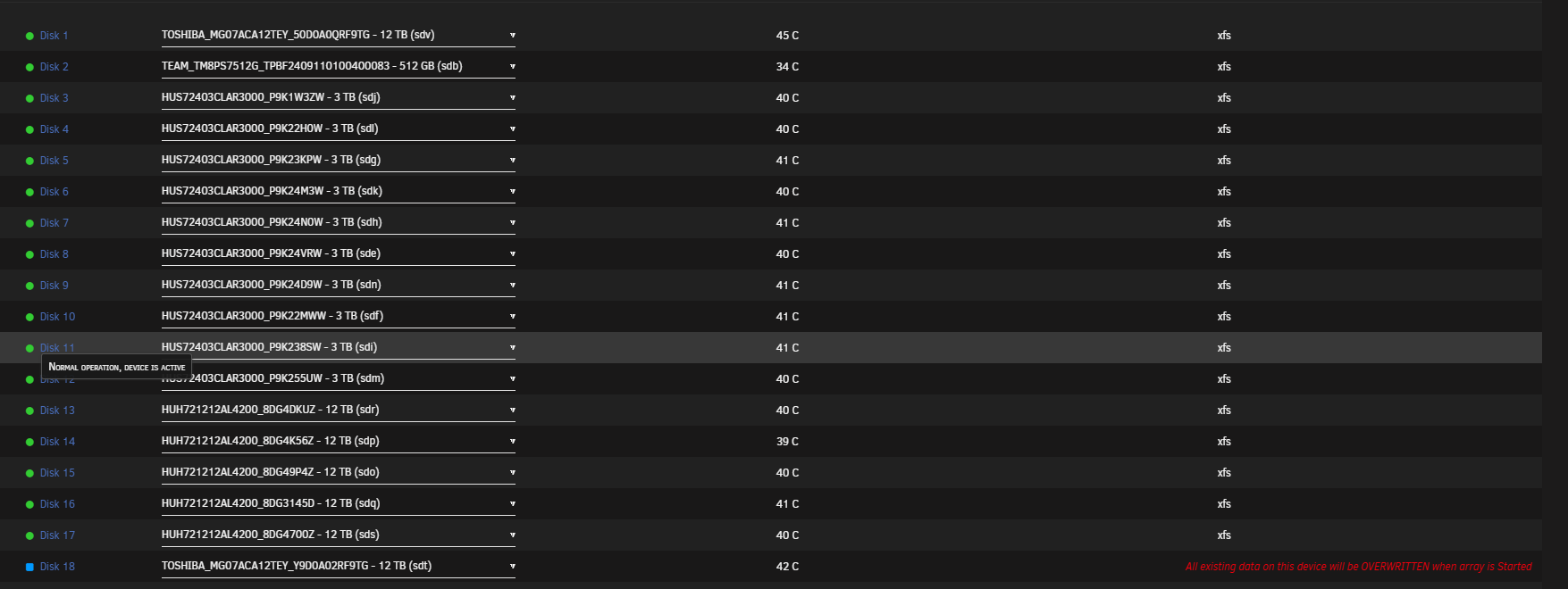

  7. Is this: Something I can add to unraid or is it available on a newer version? I'll give it a try when I'm finished rebuilding the disks.

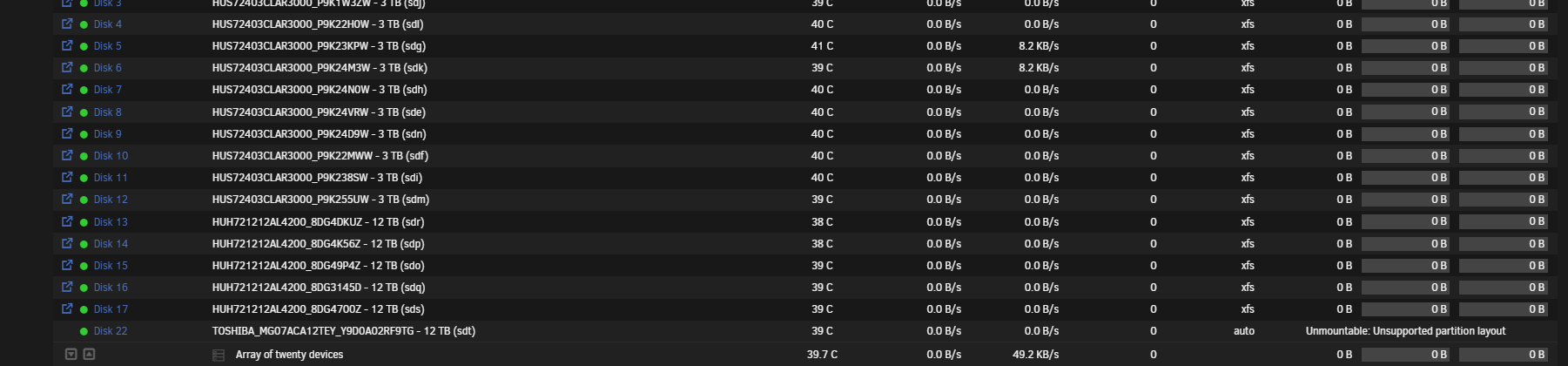

  10. My UPS is: CyberPower 1500VA / 900 Watts True Sine Wave Uninterruptible Power Supply (UPS). I have a JBOD attached to the server also on the UPS.
  11. I have a UPS. My power went out for a few minutes and the UPS kicked in. Power comes back on, I check the server and now I have write errors. The server never shut off as the power came back on before it hit the shutdown threshold. I've attached the diag. I've started the data rebuild. Only 2 disks were affected. tower-diagnostics-20250316-1917.zip
  12. I just went for it and looks like it'll work. Phew. Maybe I just need to not immediately add it or something.

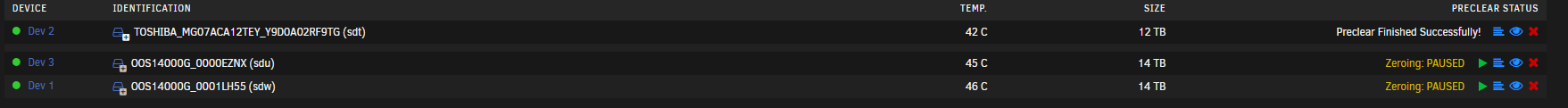

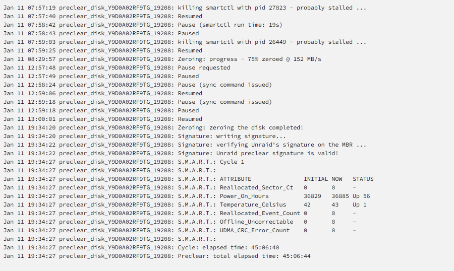

  13. I like the ability to pause the pre-clear and if I need I can restart the array while the pre-clear is happening. If you re-start while the disk is part of the array it starts all over.
  14. Is there any way to verify that the disk will not be re-erased? I had to re-do all of my 3 TB disks last time. Which was okay they took 4 hours. This one has been going for almost 48 hours. I guess it won't matter if the pre-clear plugin isn't working then I'd have to re-erase them again anyways...
