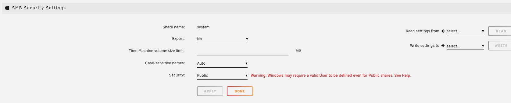

in unraid you can add that to the extra samba config.
if you have a share already enabled called video /mnt/user/video
you will need to disable the share
then stop the array.

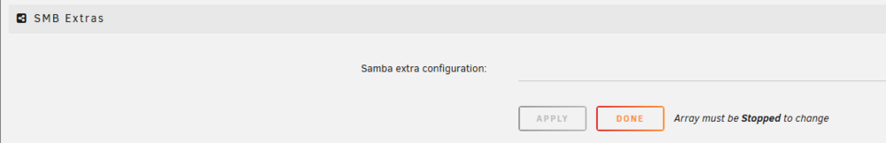

web ui > setting > samba Extra
and paste your custum share.

yes you would paste the entire share config setting and all in the extra box.
all of it
[video]
        path = /mnt/user/video
        comment = Manula SMB Share
        browseable = yes
        public = yes
#        writeable = no
#        write list = foo,bar
        case sensitive = auto
        preserve case = yes
        short preserve case = yes
        vfs objects = catia fruit streams_xattr read_ahead
        fruit:encoding = native
        guest ok = yes
        read_ahead:readahead = 65536
otherwise you can repalce the smb.conf and use a override smb via include and put your share setting in the included file as outlined in:
