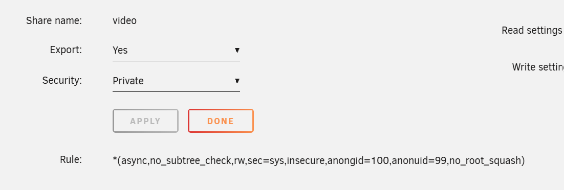

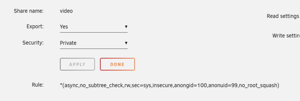

I disabled the cache and all the problems went away, even the disconnect problem that doesn't make sense as having anything to do with the cache. Unfortunately backing up is a lot slower without the cache, but I guess that's the best I'm going to get unless someone knows a reason for my share connections getting dropped.
default_perms_for_dir: sys_acl_get_file(., ACL_TYPE_DEFAULT): Stale file handle, falling back on umask
I'll take your word for it that NFS and caching don't get along, but these failures seem to be something much more. It's not like the mover is running or even gets a chance to run before those errors pop up. I completely lose the connection to the remote arrays in a short time, needing to unmount and remount just to re-establish a connection, and as soon as I run rsync the stale file handles are pouring in by the hundreds, well before the mover has any time to act. Could it be that Dynamics Cache Directories causes a problem, caching inode values that are inconsistent? I could live with the "stale file node" handles as just so much annoying noise, because, after all, it just seems to be a warning and data does get copied anyway. The much bigger problem is how the volume completely disconnects when rsync is done, and isn't connected before I run rsync unless I do an unmount/remount cycle.
Yes. Not that the mover is or has to be running at the time these problems occur, but these shares do use a cache drive, so eventually the mover will be activated. I hope that doesn't mean the only solution is not being able to use a cache.
I've seen this issue come up in some older posts, but I haven't found any useful advice yet. I have two Unraid arrays, main storage and backup. The backup array exports two NFS shares, and the main array automounts these two shares. Maybe I'd have better luck with SMB shares, but I want to maintain symbolic links which aren't supported by SMB. The problem is that even though these shares are automounted, they seldom work for my rsync backup unless I unmount then remount them each time before use, then use them right away after doing so. Here's what I see before the unmount/remount: rsync: [Receiver] ERROR: cannot stat destination "/mnt/remotes/my_share_name/": Stale file handle (116) rsync error: errors selecting input/output files, dirs (code 3) at main.c(772) [Receiver=3.4.1] rsync: [sender] write error: Broken pipe (32) rsync error: error in socket IO (code 10) at io.c(849) [sender=3.4.1] Further, even when the backup is working and writing to the remote share, I get a crapload of: default_perms_for_dir: sys_acl_get_file(., ACL_TYPE_DEFAULT): Stale file handle, falling back on umask default_perms_for_dir: sys_acl_get_file(., ACL_TYPE_DEFAULT): Stale file handle, falling back on umask default_perms_for_dir: sys_acl_get_file(., ACL_TYPE_DEFAULT): Stale file handle, falling back on umask default_perms_for_dir: sys_acl_get_file(., ACL_TYPE_DEFAULT): Stale file handle, falling back on umask default_perms_for_dir: sys_acl_get_file(., ACL_TYPE_DEFAULT): Stale file handle, falling back on umask default_perms_for_dir: sys_acl_get_file(., ACL_TYPE_DEFAULT): Stale file handle, falling back on umask default_perms_for_dir: sys_acl_get_file(., ACL_TYPE_DEFAULT): Stale file handle, falling back on umask default_perms_for_dir: sys_acl_get_file(., ACL_TYPE_DEFAULT): Stale file handle, falling back on umask default_perms_for_dir: sys_acl_get_file(., ACL_TYPE_DEFAULT): Stale file handle, falling back on umask default_perms_for_dir: sys_acl_get_file(., ACL_TYPE_DEFAULT): Stale file handle, falling back on umask default_perms_for_dir: sys_acl_get_file(., ACL_TYPE_DEFAULT): Stale file handle, falling back on umask default_perms_for_dir: sys_acl_get_file(., ACL_TYPE_DEFAULT): Stale file handle, falling back on umask default_perms_for_dir: sys_acl_get_file(., ACL_TYPE_DEFAULT): Stale file handle, falling back on umask default_perms_for_dir: sys_acl_get_file(., ACL_TYPE_DEFAULT): Stale file handle, falling back on umask default_perms_for_dir: sys_acl_get_file(., ACL_TYPE_DEFAULT): Stale file handle, falling back on umask default_perms_for_dir: sys_acl_get_file(., ACL_TYPE_DEFAULT): Stale file handle, falling back on umask ...flowing down my screen as the backups proceed. Once the rsync backup is done, the remote share is immediately unreachable again without another unmount/remount cycle. There's nothing special about the way I've configured the shares: I've also attached diags for both arrays. Anything that can be done to make this more solid and reliable? trantor-diagnostics-20251025-2206-backup-array.zip terminus-diagnostics-20251025-2204-main-array.zip
