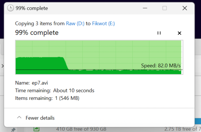

I'm not sure what you're saying here. Are you saying that the USB enclosure might have changed the way the drive got formatted? SO the disk only works properly as an NTFS volume when used inside the enclosure?
Why would I be able to use a particular NTFS-formatted disk without problem via an external USB enclosure, but then, because I wanted to try to transfer files faster using the same drive on an internal SATA connection, end up unable to mount that drive, getting FORMAT as my only option for what I can do with the drive? Please note that nothing spontaneously went wrong with the drive. I removed it as an internal drive, put it back in the external USB enclosure, and it was once again perfectly usable as an Unassigned Device.

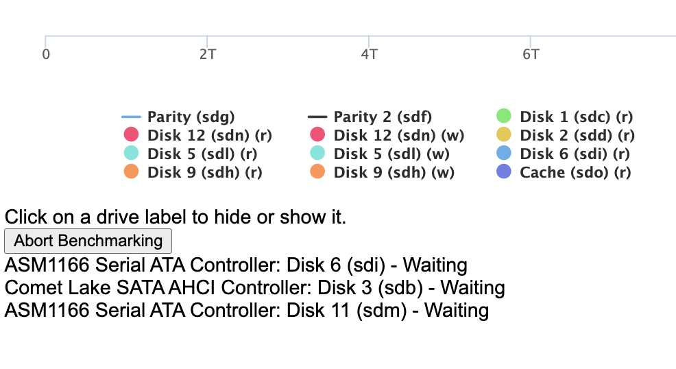

I'm trying to benchmark my array with diskspeed, but for at the least a half an hour, as I fruitlessly searched for a power adapter for an old Raspberry Pi 3B+, diskspeed has been stuck in this "waiting" state: diskspeed works fine, by the way, on my all-HDD backup array.
Painfully, achingly slow reconstruction going on - Will take about 5 days for 4.1 TB at the current rate
I'll wait until parity is rebuilt before trying the diskspeed thing... although if I'd known about diskspeed earlier I'd have tried it much sooner. Oddly, I never saw that come up in any of the searches I made looking for answers to my slow drive reconstruction problem. I've been concentrating on getting data back onto the drive that was at first being emulated, and then ceased to even be emulated -- because I guess something went wrong when I tried to pause reconstruction and it wouldn't actually pause. There was nothing on screen to warn me that the UI would falsely tell me that reconstruction had paused while drive activity made it look like reconstruction was still going, and that I should possibly wait... several minutes (which I did do) or possibly hours (which I didn't do) for the task that was supposedly paused to actually come to a halt. It still seems odd to me, at any rate, even if my forced shutdown turned out to be a bad idea, that the data on all array drives but the emulated drive, still unmodified, wouldn't continue function to recreate the missing drive. Ah, well. Live and learn. I eventually started my array up with both parity drives taken out of the array and a freshly formatted drive to replace the failed drive. (Reconstruction was never going to work on this particular new drive because it was ever so slightly smaller than the one it was replacing.) I then rsync-restored every file no longer found in this parity-less array from back up, files which mostly went onto the new blank Crucial drive. Mostly. And this is where I think a controller issue might be indicated. Even with no parity operations possible, writing to the new drive was still sluggish, in the 25 MB/s to 50 MB/s range. Not anywhere as bad as the slow reconstruction that had been going on, but still far from ideal. I couldn't blame parity generation for this slowness. At a certain point, however, new data stopped being directed to the new Crucial drive, but rather onto one of the old Fikwot drives that had been such easy scapegoats. Writing speed picked up greatly. It's hard to know how fast it averaged because I didn't time it, and the displayed speed wildly bobbed around from as low as 25 to as high as 400. Suffice to say my file restoration wrapped up much faster than it had started out. Once all files were back in place I stopped the array, added back the parity drives, started up again... and that's where I'm going to be for a while yet, with parity being reconstructed, at a too-slow but not-at-as-hideously-slow speed as drive reconstruction had been going. I'll be very curious to find out if one or more drives are simply running on slow controllers. Some drives are plugged directly into the motherboard, while others are plugged into two different added-on SATA cards. Maybe some of those SATA connections suck.

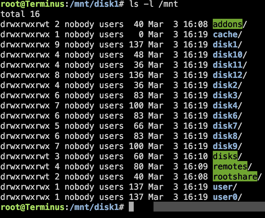

Even weirder still... I put the very same drive back in place to be rebuilt, and now the rebuild is going MUCH faster (no problem writing quickly to the same drive now!), but /mnt/disk5 still doesn't exist, and I'm pretty sure I'll have to replace a bunch of missing stuff from a back up.
I've posted diags at a number of points, including with the array started. Here are some more, with the array started, shares and files visible from other computers, but still no /mnt/disk5. What's more disturbing is this: Although the tooltip for disk 5 says "Device is missing (disabled). Contents emulated"... the contents aren't emulated. I seem to be missing whatever was on that drive, as a comparison to my backup array shows. terminus-diagnostics-20250303-1651.zip
Nope. Not there. That's the favorite go-to answer at least, no matter how weird and inconsistent that is with how the drive in question functions when not used in the array.
