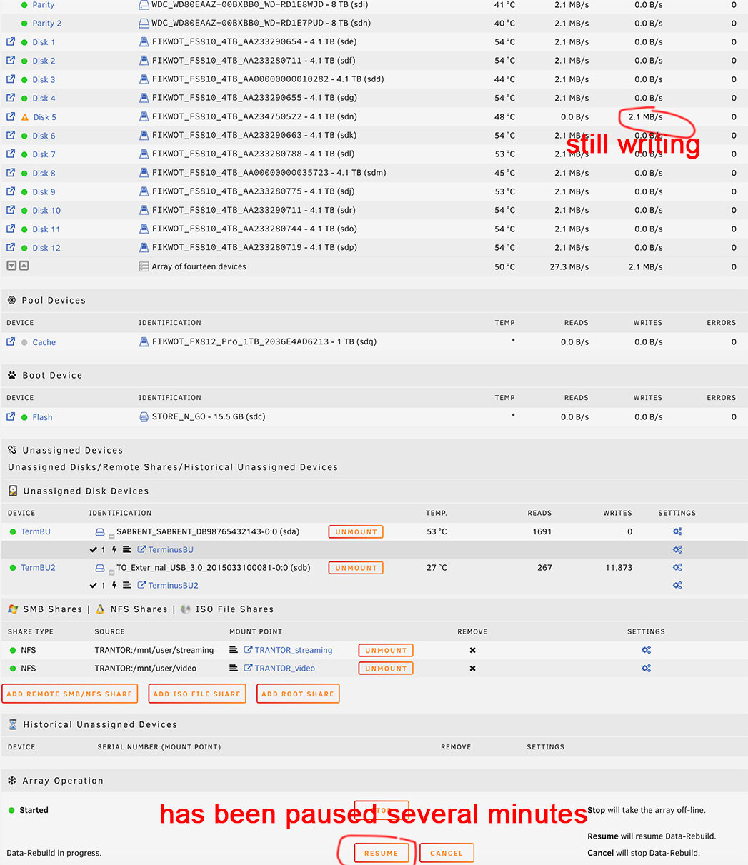

  1. I shut down through the web interface, but that wasn't enough. I had to force power-down my array. When I started back up I took the drive I was trying to rebuild to out of the array first, figuring I'd start up without it, the former contents emulated. The array started up very fast this time. I think we have to consider that the real reason my rebuild was going so slowly before was some rogue process eating up a lot of CPU time and locking up resources, not the oh-so-easy-to-blame drive with a funny-sounding brand name. Sadly I didn't realize that the emulated contents of drive 5 would only be available via a share, and not /mnt/disk5. That makes copying what would have been on drive 5 to the new Crucial drive quite a challenge unless there's some shortcut I don't know about.
  2. I got tired of waiting so I stopped my array and took the drive I was trying to rebuild to out of the array. I figured I'd just restart with drive missing and copy from the emulated drive to the external drive. Well, a few minutes later and I'm still at "Starting...". Under /mnt none of the array drives have appeared yet. One CPU of four keeps frequently pegging at 100% although I can't figure out what the array is up to with all of that CPU effort. Some more diags for ya. terminus-diagnostics-20250303-1603.zip

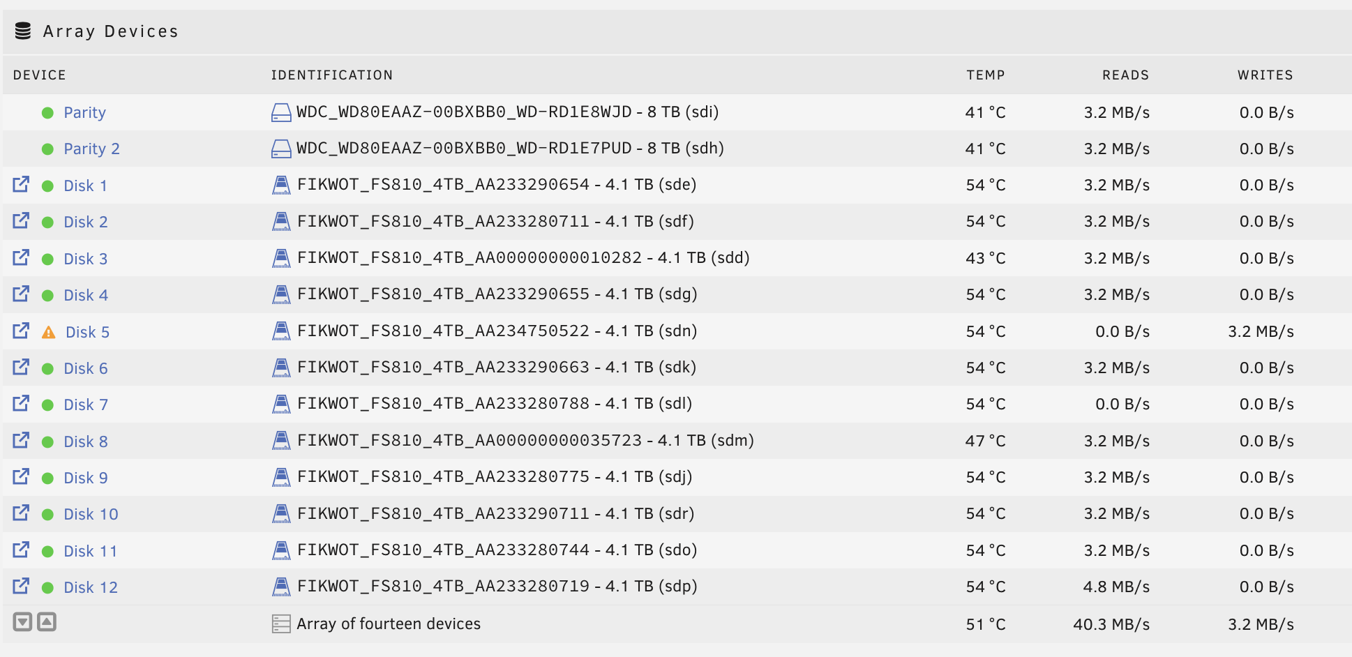

  5. My array currently consists of 2 8TB HHDs for parity and 12 4.1 TB SSDs. Yes, I know support for SSDs is only considered "experimental". But before anyone harasses me about that, I would dearly hope that they would consider there's nothing about using SSDs alone that should explain performance THIS BAD. I've definitely seen these drives show much faster read and write speeds. Functioning in the array the read speeds are always high, as high my 2.5 GB wired network allows at around 200-250 MB/s. Write speeds are slower in-array, but still typically in the 50-100 MB/s range. One of the same SSDs used as an "unassigned disk" allows writing at up to 150-250 MB/s. I recently took all of the disks out of the array configuration, gave them a good TRIM which they can't get while in-array, then reconstructed the array and rebuilt parity. That was a bit on the slow side (it was my first experiment with HDDs for parity along with SSDs for data), but still took less than a day. I've tried some recommended disk settings like this: ...but to no avail. It seems to be that there's got to be some crazy kind of bottleneck here, but what that might be I don't know. Blaming individual drive performance doesn't seem to cut it as an explanation for what's happening. terminus-diagnostics-20250302-1523.zip

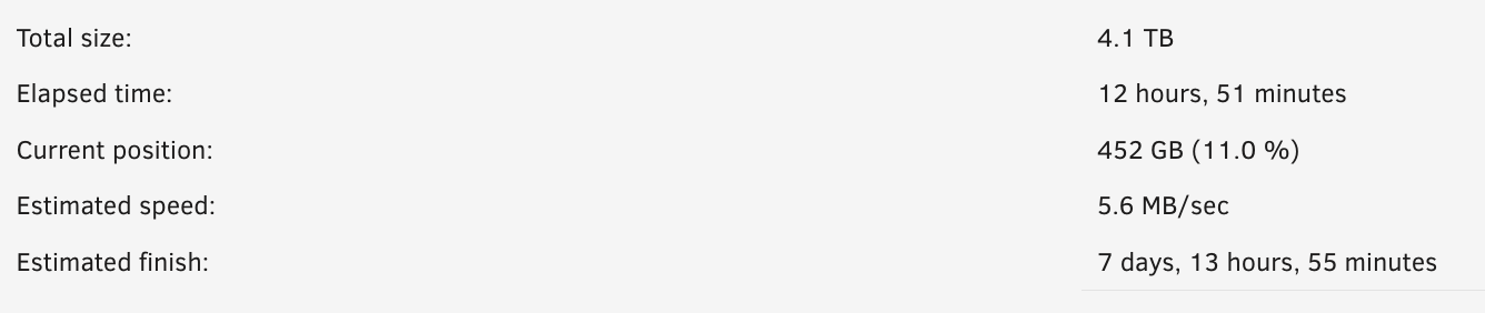

  8. It looks like the answer is yes, the last 4TB will go a lot faster than the first 4. Oddly enough, the speed picked up quite a bit a little before the very end of the data drives was reached, as if the last dregs of real data could somehow be read and processed faster. When progress hit 51.2% all reading from the data drives stopped. The parity drives are now being zeroed out at a fairly steady 180-190 MB/sec. Estimated remaining time is a little over five and a half hours -- I think that's a fairly good, reliable estimate because the value isn't wildly bouncing around as it often does. The first 4TB of parity took over one full day to be completed. That perhaps could be really be more like a little under 24 hours if you subtract a 2-3 hours when I paused the rebuild (I'm not sure if the paused time gets subtracted from the elapsed time or not). But either way, yes, when there's no real work to do reading and computer parity, it looks like the parity building process can run at steady, fast pace, about as quickly as the drives will accept data.
  9. I wasn't expecting it to give up. I'm wondering if the rebuild process will do the last half a lot faster, since there's nothing to read from other drives and nothing to compute. As the rebuild is at 49% right now, I should know fairly soon. The data drives are slightly larger than half the size of the parity drives, so it will be just a little past 50% when there's nothing left to read from the data drives anymore.

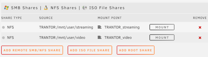

  14. After rebooting, why do I have to remove and re-add NFS shares to mount them? I have a pair of of shares that look like this: MOUNT is always grayed out and inoperable after a reboot. I have to remove one of the two shares, then re-add that share, before either share can be mounted. Beyond that, even after mounting one of the shares, they seem to time out after a while, so I have to unmount and remount (at least not remove and re-add) the shares to use them. These shares are provided by a separate Unraid server. Both arrays are running Unraid 6.12.10.
  15. After a reboot, I have a pair of of shares that look like this: MOUNT is always grayed out and inoperable. I have to remove one of the two shares, then re-add that share, before either share can be mounted. Beyond that, even after mounting one of the shares, they seem to time out after a while, so I have to unmount and remount (at least not remove and re-add) the shares to use them. These shares are provided by a separate Unraid server. Both are running Unraid 6.12.10.

  23. You mean for the third time today? 😁
