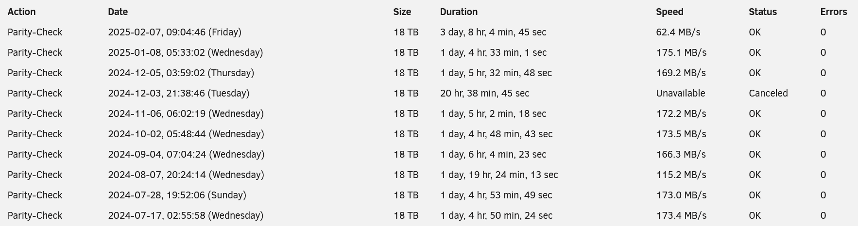

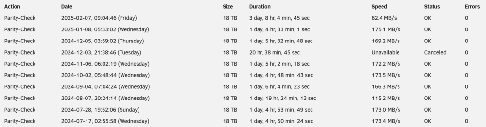

One other thing to add...  If you're writing to the array while the parity check is running then everything will slow down.
Here's a bit of a comparison for you.  Notice that my last check was quite slow because a massive sync happened to be running when the scheduled parity check kicked in.
