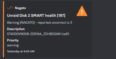

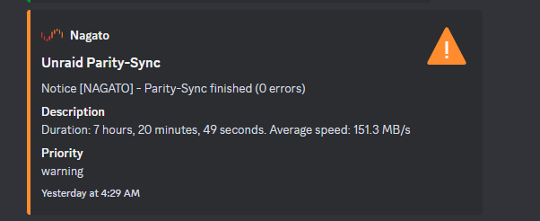

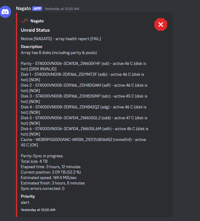

Apologies for not replying until now, to answer your question, I have not performed any steps. My system is in the same state, drive 2 has failed...
I replaced my parity drive which was having smart drive errors as well:
All the drives heated up overnight:
Then, after a while I got this message:
But then right after I got this one:

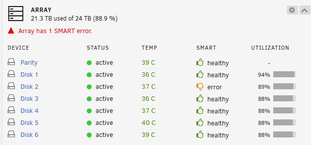

So disk 2 in my array is now bad... and that's where I am at now. Like I said before I didn't run any steps or anything else, I guess I made the assumption that my parity is bad because drive 2 reported read errors after the rebuild of the parity drive.
If you think (by the diagnostics) that I am OK with parity, then should i go ahead and just replace the drive as normal and rebuild?

Disk2 should be replaced, would prefer to see the diags to confirm, but based on the notifications, looks like there weren't read errors during the parity sync.
Thanks all! I will run the replacement this weekend and let you know how it goes!
Follow-up: Just finished the rebuild with no issues. Thanks again for all your help!
