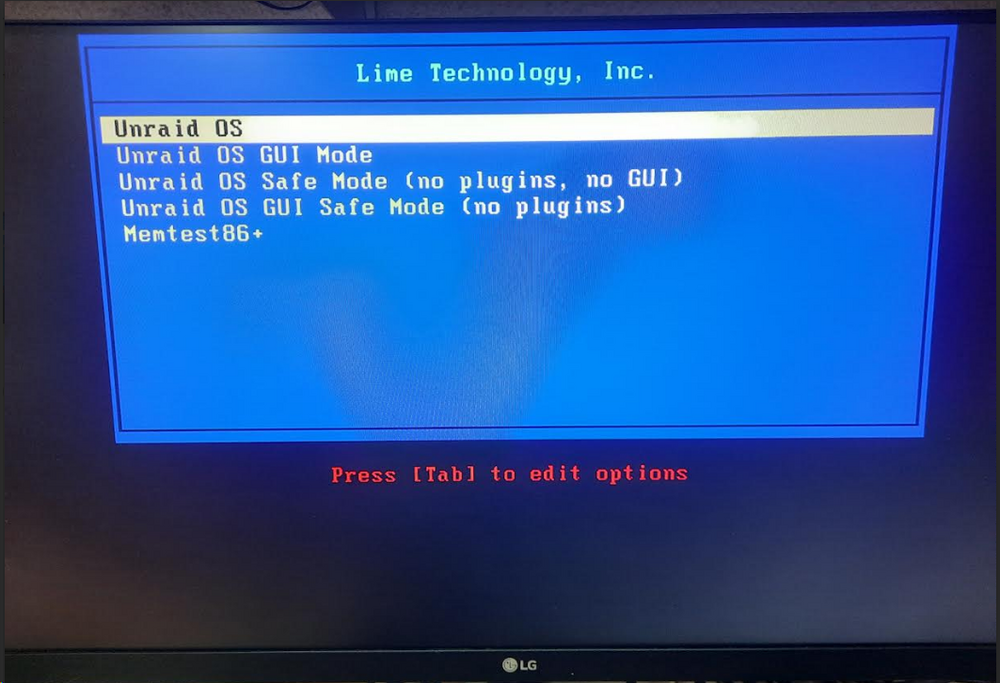

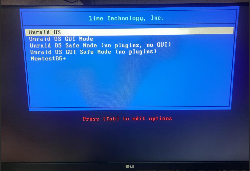

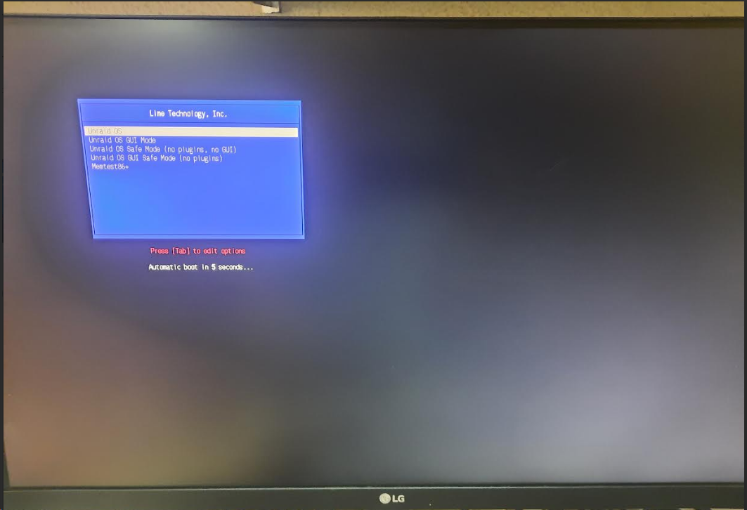

In the two machines I tested at work, in BOTH of them USB stick booted in EFI mode! I saw the blue menu!
OK I said, something wrong specifically with my home motherboard (although one of them at work was same brand and similar age with my home one).
So I went home ready to install the graphics card. But first I tried just once more.
STICK BOOTED! IN EFI!
I swear I haven't rouched anything.
Then I thought, maybe I somehow fixed it with the stock and didn't realize.
So I dropped over the stick my own backup of UNRAID USB, but didn't touch the EFI and syslinux folder, plus a few more files I knew didn't differ in version.
THIS WORKED TOO!
So no my UNRAID just... started booting fine in UEFI mode!
