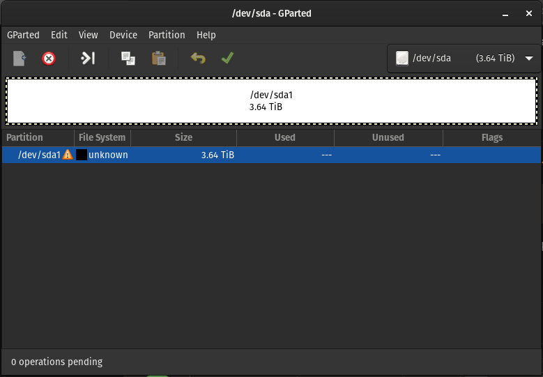

This might be a little confusing so please bear with me. I still have the disk that I originally tried to add a few weeks ago. I wasn't sure it if was precleared, so I installed it to my desktop and found it was precleared or at least gparted doesn't know what do with it (image of gparted added).
