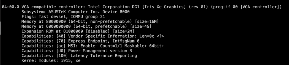

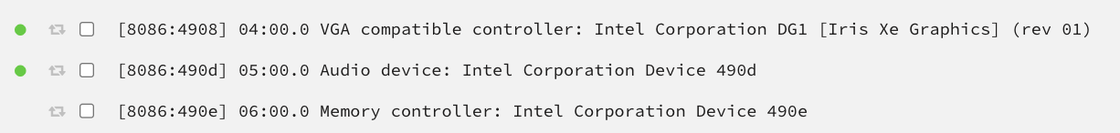

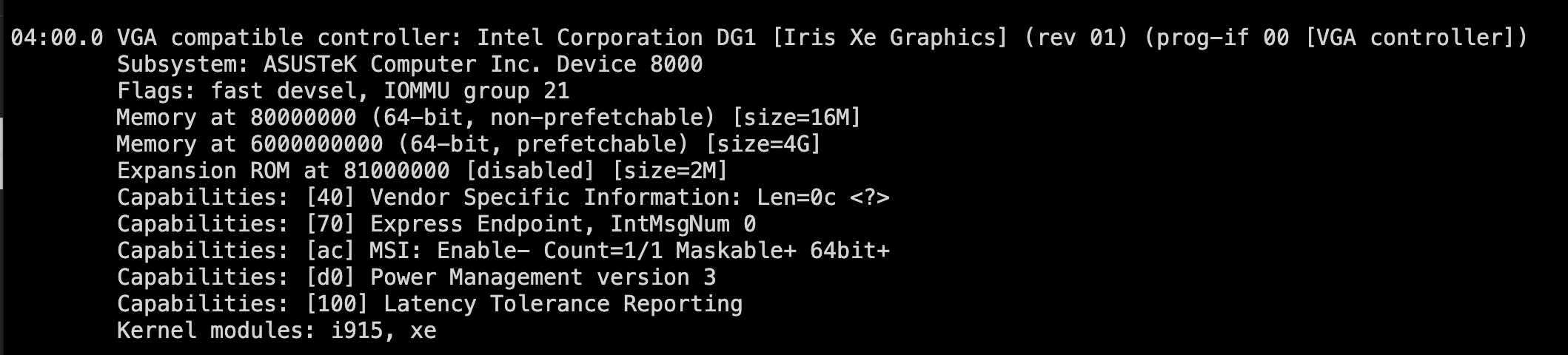

xe driver can't be used in unraid 7.1 beta
dg1 gpu can be seen in system devices, config  has been set as below, but can't still be used.iShot_2025-03-28_11_49_21.thumb.png.7aa568ed294670b890bffe272316b60c.pngiShot_2025-03-28_11_49_43.thumb.png.5d4a755c38d30d380f5f1257e14fe5db.pngimage.thumb.png.2600333b57453e8a8aaab2e06b0dd410.png

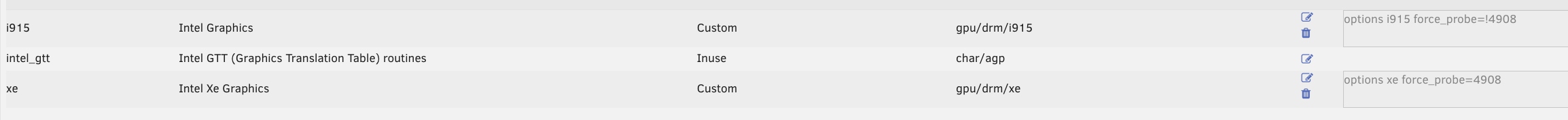

system drivers has been modified like
image.thumb.png.431d61a0ffea9e5571a041191dc7694e.pngimage.thumb.png.431d61a0ffea9e5571a041191dc7694e.png
Did you reboot after adding entries to system drivers?
sure i did, just don't work

You modprobe files on the boot should look like this.
root@computenode:~# cat /boot/config/modprobe.d/i915.conf
options i915 force_probe=!4908
root@computenode:~# cat /boot/config/modprobe.d/xe.conf
options xe force_probe=4908
root@computenode:~#

thank you!

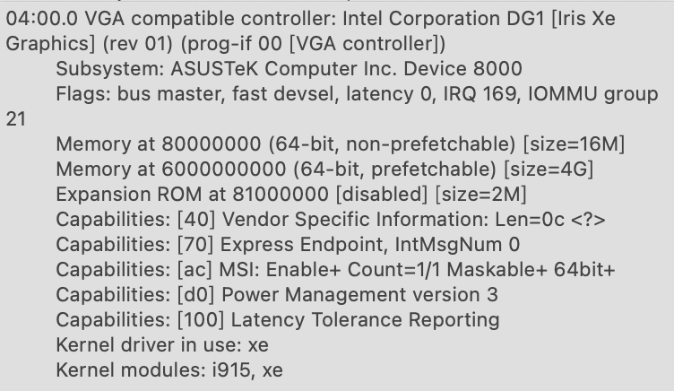

xe driver could be used now, but there is still some problem

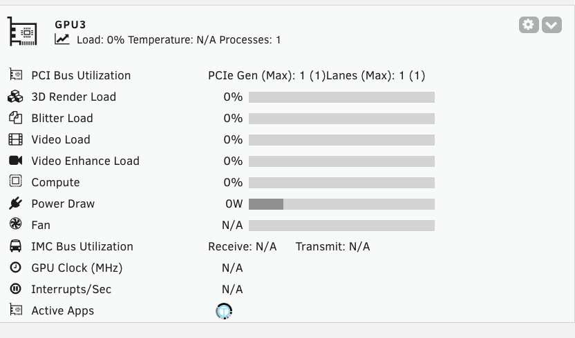

gpu statistics seems don't work with dg1, information about dg1 can rarely be shown.
i changed bios setting for dg1 to be in pcie 3.0 *4, but seems it only worked in pcie 1.0*1
  • 4 months later...
The pcie bug is only a display one and well known for Intel Arc. lspci shows since years only pcie gen1 x1 but the cards are still functioning normally with their full bus.
