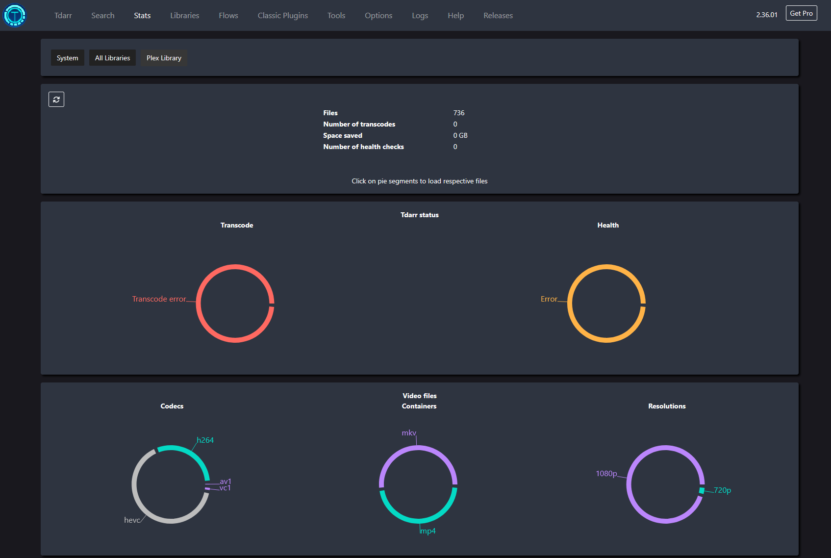

See also image attached for the TDARR UI

You have junk in your temp folder, delete it - any other issues should be taken up in the container's help topic or at the tdarr forums, this isn't an unraid problem so this forum isn't appropriate
Thanks! I'll go for further help to the TDARR forum. It's a good point you brought that up. Apologies.
Fixed it, there was a typo in the paths.. Very basic rookie mistake...
