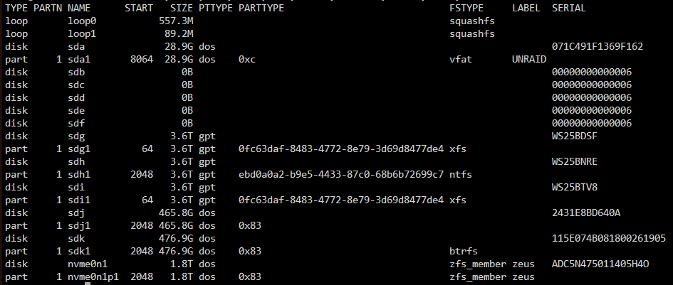

I had Unraid up and running without issues in the OS. Had some issues setting up a Docker, lagged for a couple days due to day job and annoyance, then decided to go with a larger main parity drive and installed a fresh drive for that. When installing the new parity drive, once the OS started and I was assigning drives I chose the new largest drive and then could not find the old parity drive. Thought it weird but started the array anyways without finding the old drive. Probably not the proper way to add parity drives. It seemed to work, but then I was annoyed at not finding the original parity drive. After a restart minutes later, my new parity drive was also gone and an array drive missing. Restarted the PC and the array drive had returned, but both parity drives were still missing. I changed SATA cables, changed PSUs, switched to using a SATA PCIe card, and nothing made the parity drives come back. Plugged one of the parity drives into my Desktop PC with a USB SATA box and it showed up in device manager but not under drives. It had a partition still and seemed in good health. So what gives? What has happened and what do I change to find and use my drives again for parity?

janus-diagnostics-20250328-1208.zipArray.thumb.png.2aecb2be49555f29af372d02183e31fa.pnglsblk-lostuff.png.3b394f06bb2e9d73d75f1380b0bb0ab4.png

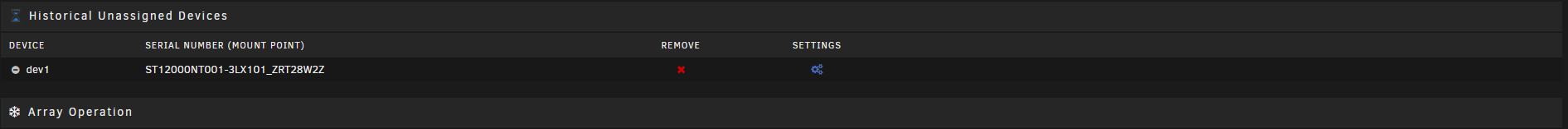

Hold up. The drive is now showing up in OS under Historical through Unassigned Devices app.
Seagate IronWolf Pro 12TB, connected to SATA port 1.
All other drives are on the SATA PCIe card. The 12TB was connected there minutes ago.
I have moved both parity drives from direct connect on the board to PCIe a couple times testing and now it shows up...
That still means it's not being detected.

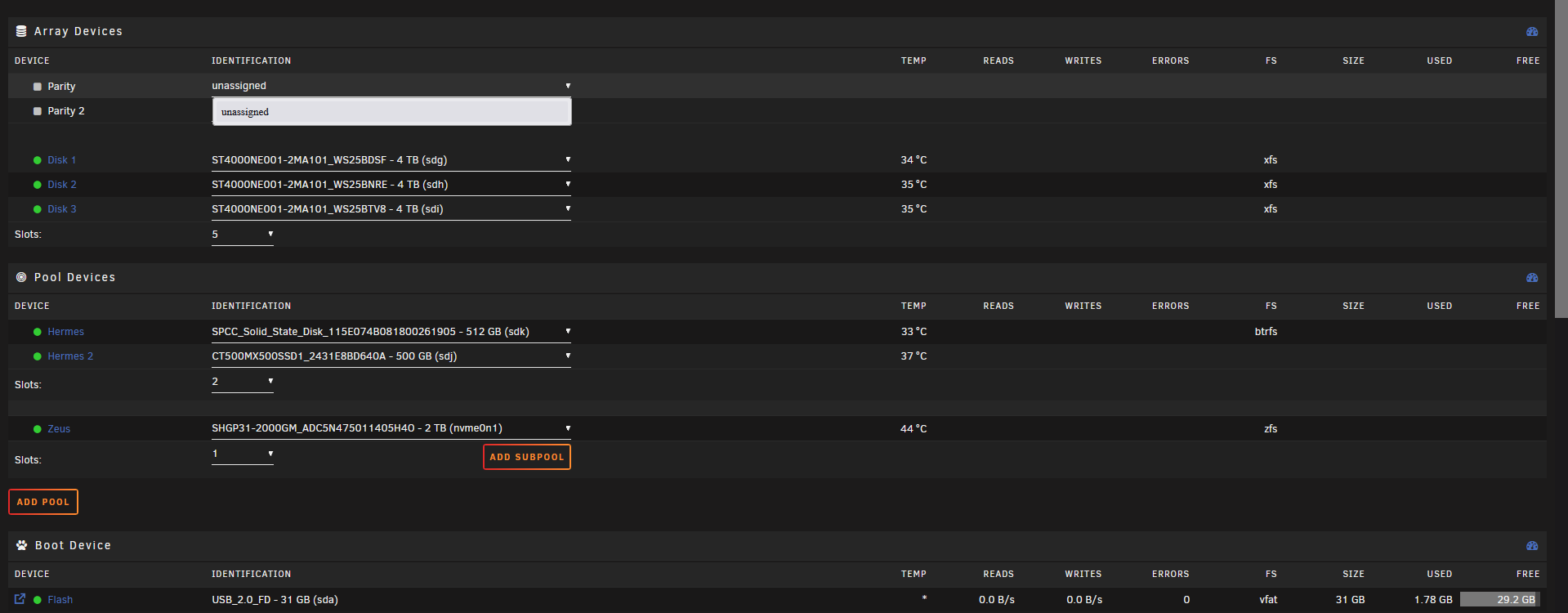

The 12TB shows as an option to assign as the parity now. After restart it still exists.
The 4TB original parity drive is still invisible to the OS but shows in the BIOS.

Parity doesn't mount since it has no filesystem. If it shows as an option to assign and stays assigned that is what you want.
Well, technology is magic, and you can't always see the problem or solution. Both drives are currently in the process of a parity sync. I am baffled as to the error of my ways. Both drives are currently directly connected to the board via SATA ports 1&2, where they were originally when I lost them... The rest of the array are still on the SATA PCIe card.
