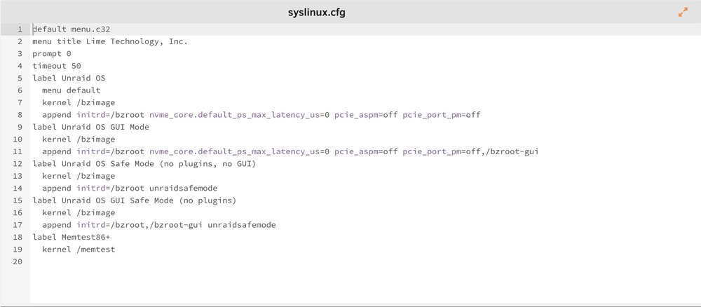

  • Added "nvme_core.default_ps_max_latency_us=0 pcie_aspm=off pcie_port_pm=off" in syslinux.cfg after "append initrd=/bzroot" under the Unraid OS label.

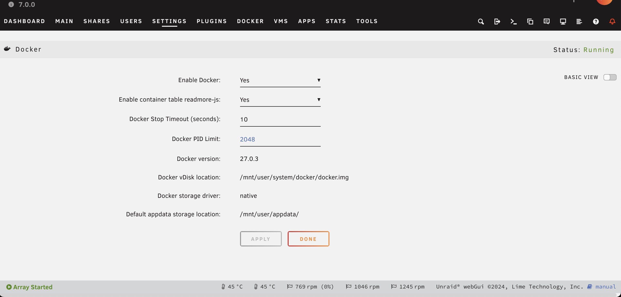

According to the diags, the Docker service is running, post a screenshot from the Settings - Docker page.
Yes, I restart the server to get it to work again. Eventually it'll crash. Another thing I just did the "restore config" in Back up and Restore. hoping it meant for the flash

Try adding "nvme_core.default_ps_max_latency_us=0 pcie_aspm=off pcie_port_pm=off" as a kernel boot option, after /bzroot
This is what I've already inputed, is this correct?
Yep, if that doesn't help recommend trying a different brand/model NVMe device, or a different board.
