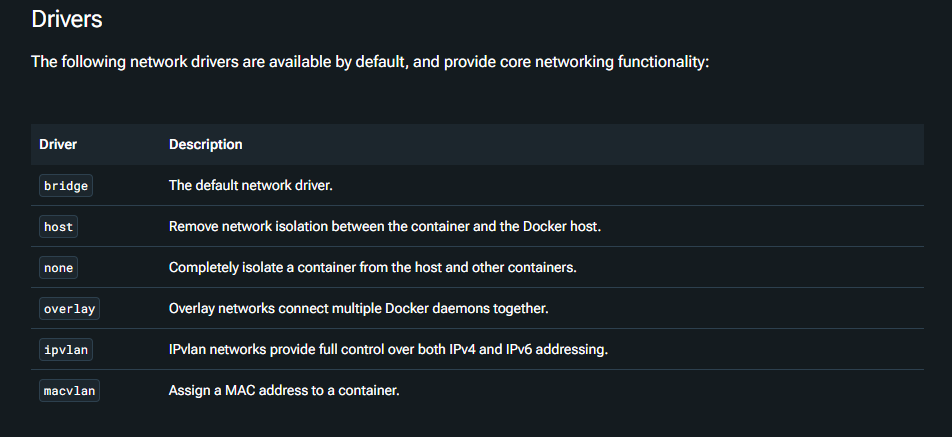

OK, First lets Review Docker Netwroks in general
Docker Docs:
https://docs.docker.com/engine/network/
and how the driver types dictate the docker networks...
Heres a break-down:

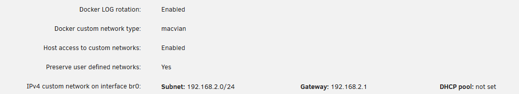

This is dictated by 3 settings across unraid.
Network settings:
Docker settings:

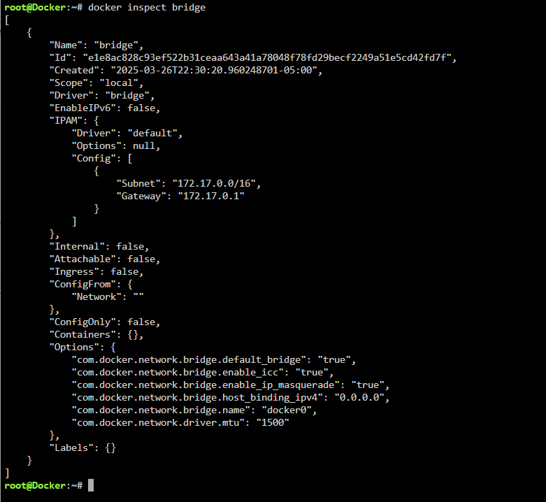

Using terminal commands, we can check with docker inspect commands...
docker network ls
will list the current docker networks your host has access too can, can use...
note the docker name...

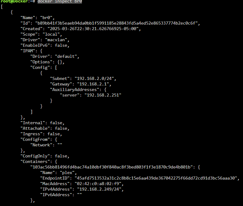

docker inspect br0
using a inspect command, we can get data on dockers connected and what the settings are for the network example:

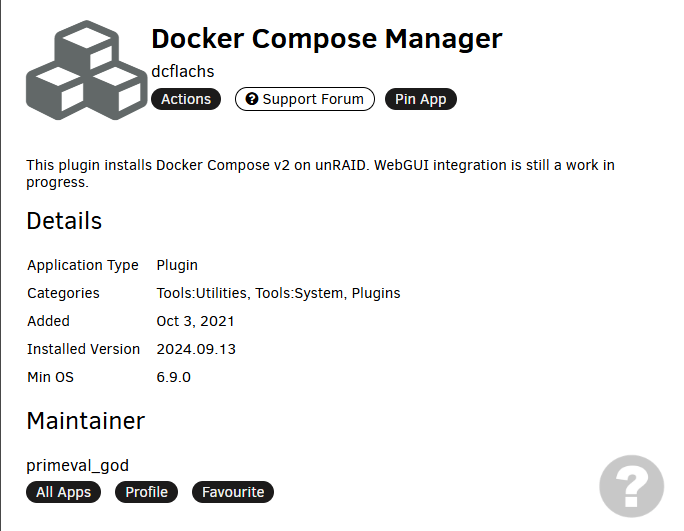

we will use this plugin:
To run unraid webui dockers as compose files...
