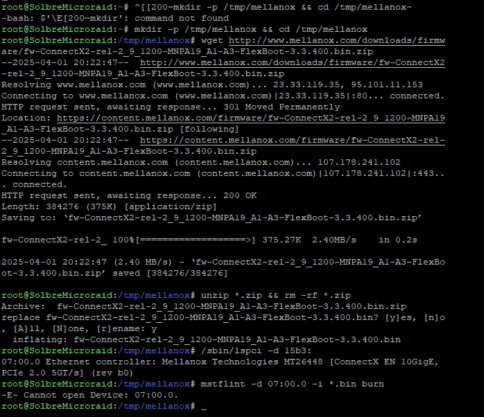

Cant update the firmware... Any tips on this?

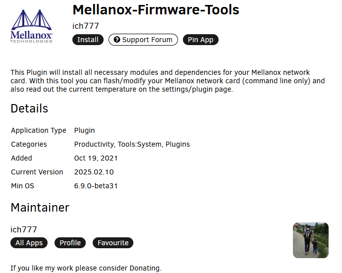

I recommend you install the Mellanox Firmware Tools Plugin (Optional but Helpful)..
as this gives access to mstflint, lspci, and other required tools...
Based on the picture. Flowing others guides...
Steps to Update Mellanox Firmware on Unraid (Slackware/Linux)
Create a working directory
mkdir -p /tmp/mellanox && cd /tmp/mellanox
Download the Firmware
Use wget to grab the .zip file from Mellanox (now part of NVIDIA):
wget https://content.mellanox.com/firmware/fw-ConnectX2-rel-2_9_1200-MNPA19_A1-A3-FlexBoot-3.3.400.bin.zip
Unzip and extract the firmware
unzip *.zip && rm -f *.zip
Verify card is detected
lspci | grep -i mellanox
You should see something like:
Ethernet controller: Mellanox Technologies MT26448 [ConnectX EN 10GigE, PCIe 2.0 5GT/s]
Burn (Flash) the firmware
Make sure mstflint is available (it is if the plugin is installed), then
mstflint -d 07:00.0 -i *.bin burn
Replace 07:00.0 with your actual PCI ID if different (lspci will show it).
*.bin should match the extracted firmware filename.
Reboot to apply firmware as after a flash the device needs to be powercycled.
Check Firmware Version
After reboot, you can confirm the updated firmware
mstflint -d 07:00.0 q
If anything fails or you get weird errors (like device not found), you might need to run
mst start
-to load the Mellanox drivers and reinitialize devices.

Maybe. This card is in a HPE Microserver Gen 8, but i have a other Unraid server with X399e Motherboard with a Threadripper too and getting the same issue.

Getting the same error. ' -E- Cannot open Device: 07:00.0 '
