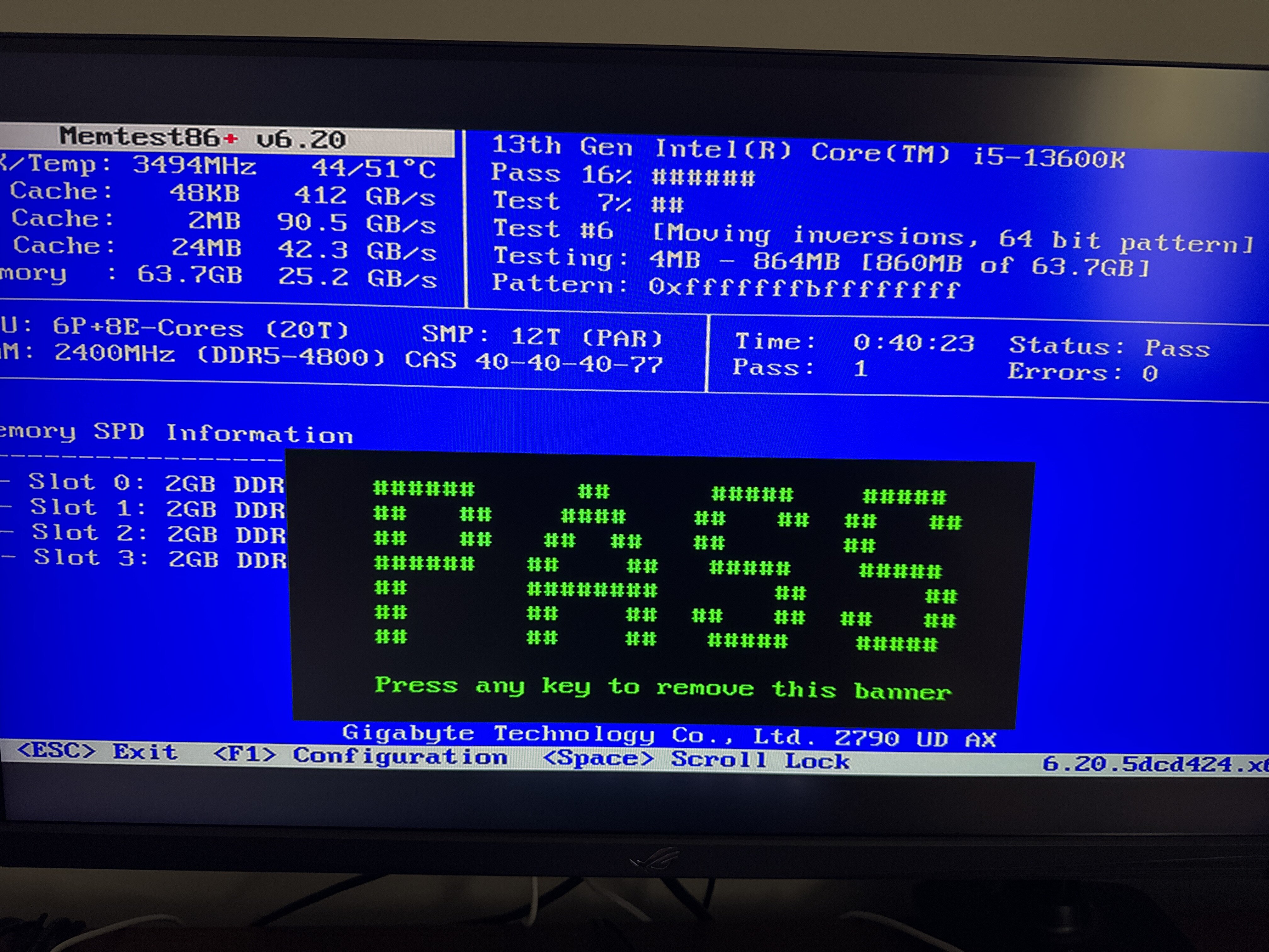

yes
The memtest passed
anything else to check ?
9 hours ago, trurl said:
yes
Note that memtest is only definitive if it finds errors, if you have multiple sticks try using the server with just one, if the same try with a different one, that will basically rule out bad RAM.
One other thing you can try is to boot the server in safe mode with all docker containers/VMs disabled, let it run as a basic NAS for a few days, if it still crashes it's likely a hardware problem, if it doesn't start turning on the other services one by one, including the docker containers.
alright I will try that but is there anything in the syslog indicate I have a bad ram ? because I don't understand anything from it sorry if this stupid question

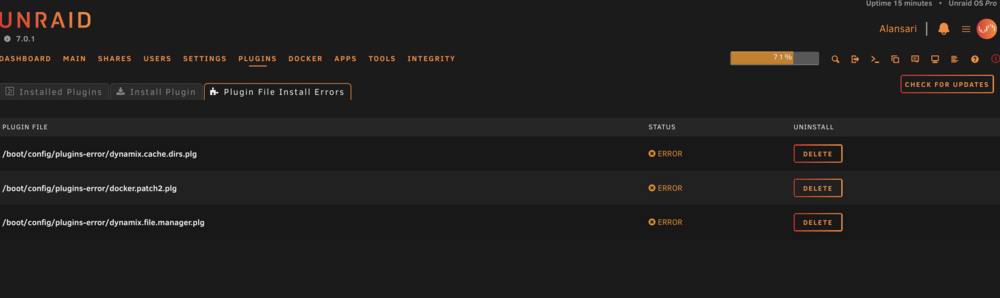

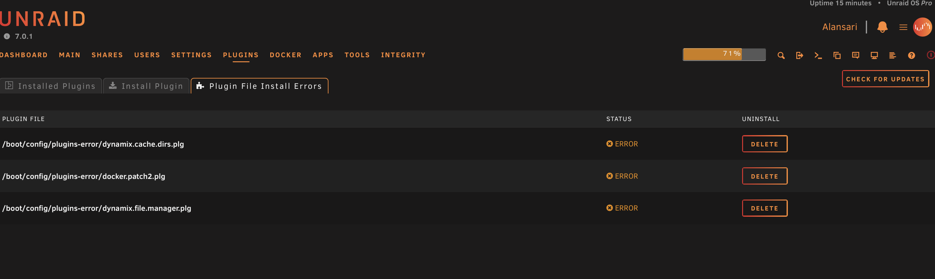

I found these as well in the plugin page should I delete them?
No, it's just one of the more common reasons for stability issues.
You can delete those.

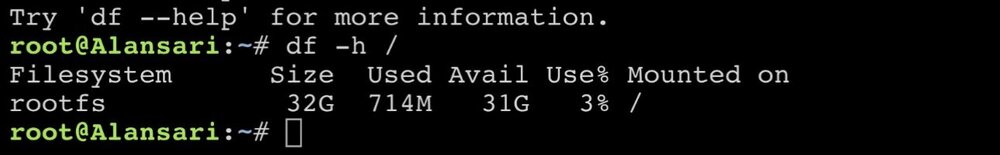

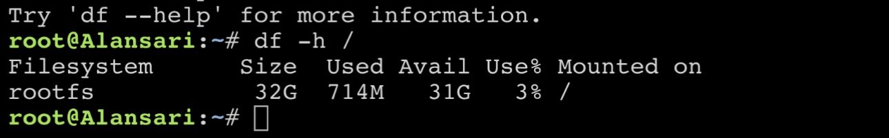

What do you get from command line with this?
df -h /
df -h /
11 hours ago, Alansari said:
can it be from the usb stick?
It's a possibility.
