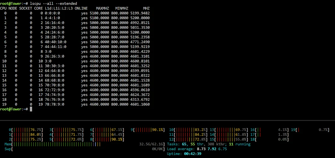

Issue: My VM is just overall sluggish. There is a slight delay in everything and anything i do in the VM spikes all the cores to 100% no matter how little it is, ie. example clicking the start menu spikes all the cores to 100% momentarily. I can open the video game i play primarly successfully, but its slow to start and load with around 30-40% of the FPS of baremetal.
On Bare Metal: Path of Exile Performance: Ultra everything 4k w/60fps target. The game is super snappy, loads near instantly and fps is locked on 60fps and barely dips into the low 50's on extremely juiced content. Built in game stat overlay shows CPU 3-5ms/GPU 7-12ms latency. CPU's mostly chill in the 30-40's on the first 8 cores and occasionally spike into the 90's on really juiced maps. GPU sits around 40% usage
On VM: Path of Exile Performance: Ultra everything 4k w/60fps target. The game is ok, not very snappy, takes about 30 seconds to start the game and loading content is not instant with loading times between 10-20seconds. The fps is low, 20-30s with the target set at 60fps. Walking into an area with lots of content stutters the game down into single digits fps. Built in game stat overlay shows CPU 35-50ms/GPU 10-15ms latency. CPU's mostly sit in the 90's on all 16 cores and spikes to 100% constantly making the game stutter. GPU sits around 17-20% usage

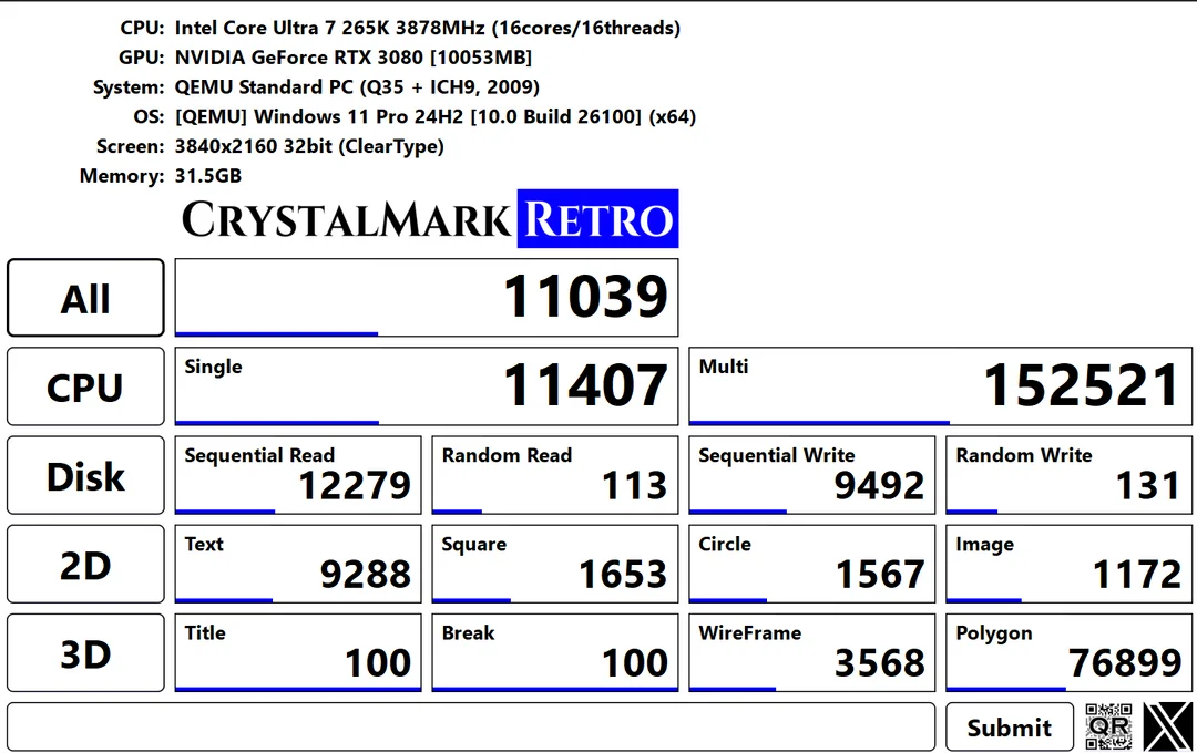

Crystal Disk Mark:

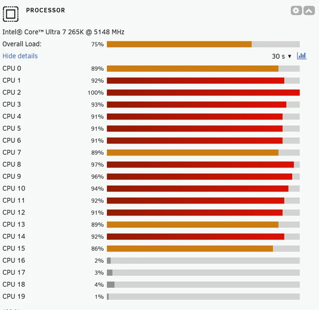

CPU's while gaming in VM:
HTOP;

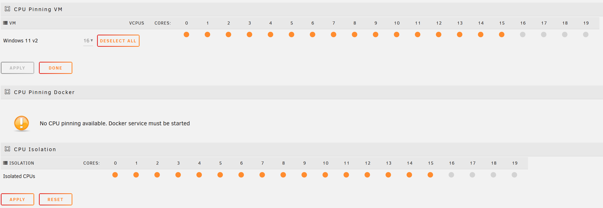

  • 11 months later...
Did you ever resolve this? I found this thread while looking for information on pinning VM CPUs and I see that you have pinned CPU 0/1 to your VM. Everything I read says that you should not pin these, but you should ISOLATE these cores so that Unraid can use them exclusively for system management.
