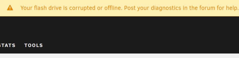

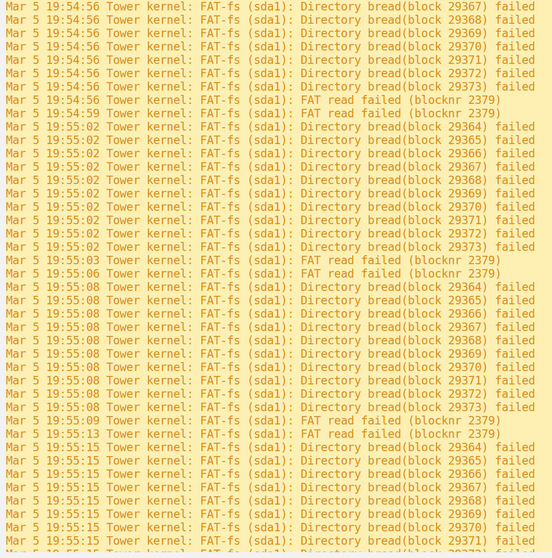

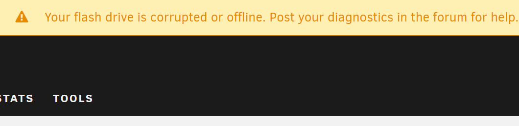

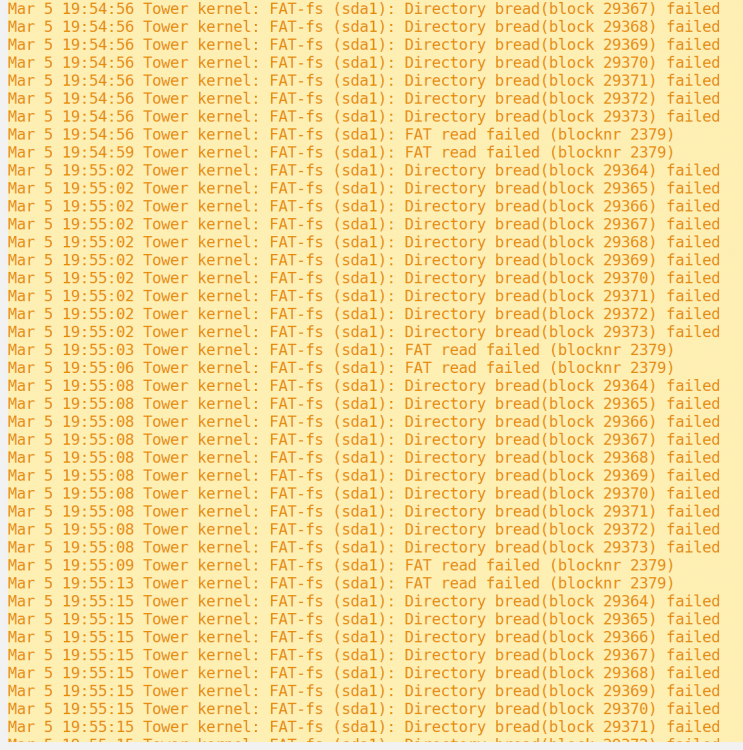

  7. Well.. it turns out my issue was not a failing flash drive apparently... Someone messaged me and informed me their is a bug with Unassigned Drive app update recently, that would grab the unraid boot drive and cause the server to drop into a massive error state, displaying tons of read errors on the flash drive. They informed me that when it updated randomly for my server, it caused this bug and all i needed to do was delete UD and restart the server, which i did and it booted up as if nothing ever happed displaying 0 errors now for the unRaid boot flash drive.. with good smart report..
