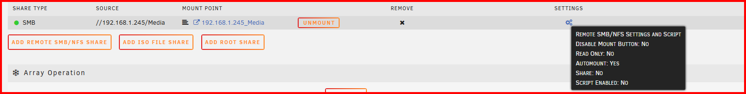

On 4/9/2025 at 1:17 PM, geefle said:
have SMB mounts to another machine for backup. To save energy I only turn on that host when the backup job is running.
There is an option to Automount a share as shown below:
Since the other computer is generally off, why not just manually mount after you start that computer...
@frank. I run a backup script that boots the other server using WOL. I wanted to also mount the drives via script but could not find a way to do that. That would be my preferred option the script would mount the drives run the backup dismount the drives and shutdown the server
