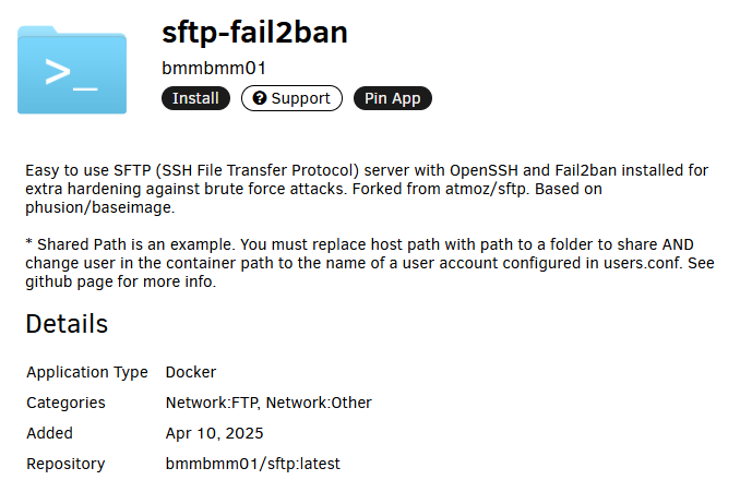

SFTP (openssh and fail2ban) Server
Overview: Easy to use SFTP (SSH File Transfer Protocol) server with OpenSSH and Fail2ban installed for extra hardening against brute force attacks.
Reason: I Use the docker instance and it hadn't been updated in some time. So I decided I still want this, but I needed a Updated Fork of MarkusMcNugen/docker-sftp Orginaly Forked from atmoz/sftp... Due to age of application, It was time for a refresh....

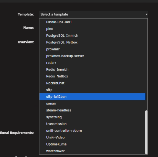

The Unraid CA Templates setup and shipped to be an easy install and done...

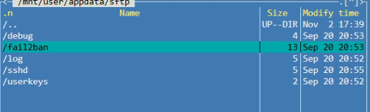

Fail2ban, sshkeys, and other need docker data will be made in the /config apppdata marked template folder.

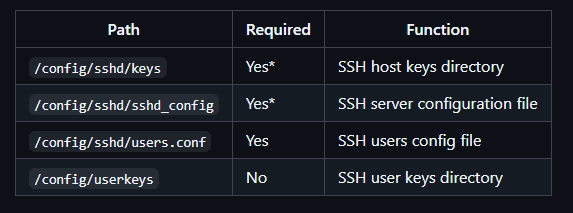

There is a /stage folder that has the original configs. The entry point script will remake the /config a Volume is not needed to run this docker. The Entry point Script has had some updates and the Docker Log will be able to explain and show issues. Fail2ban and sshd have been updated and scripts/configs updated. If you want to make edits to sshd, fail2ban, and jails configurations asl long as they exist in /config they will be deployed and used. A major edit was done to use the ubuntu package maintainers files and our edits to run are now using the .local file the fail2ban preferred way...
Entry point Script will make any missing files and set correct permission for any add configs and user keys...
SSH
Fail2Ban
*These files are automatically created if they are not present when the container is started

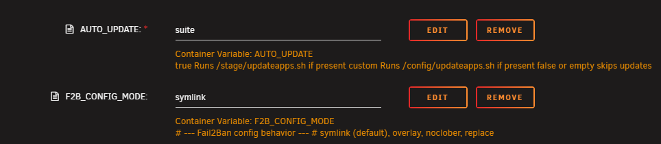

With some CVE on openssh 9.6 I decided it was time for a build update...

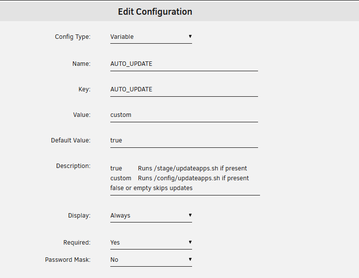

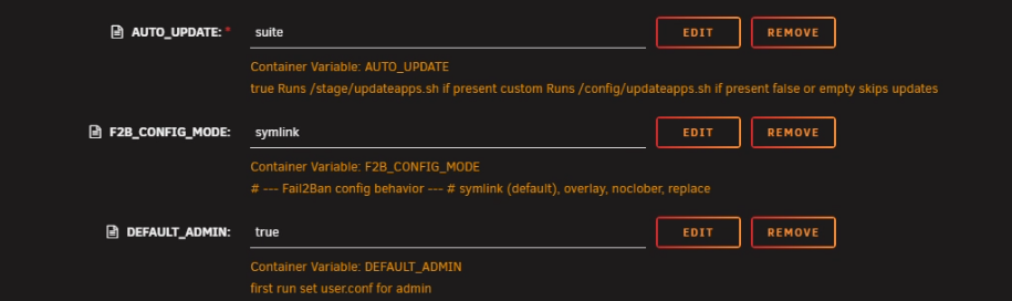

I have also added a docker variable for the update script.
Unraid CA Template has been updated as well
This will give users the ability to use the /config and there own custom script as mentioned above (can be sued to sideload or interact before docker services start....
or set the docker variable to a Boolean values of T/F to run/not run the default script above which when ran will check and install the latest openssh (Client and server) and fail2ban before docker services are active...

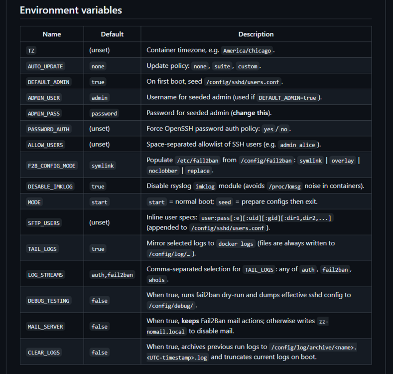

Introducing Project SFTP2
well looks like its time for a bit of a rebuild as OpenSSH move to version 10...
The update script scraped the pool and pulled OpenSSH 10.0p1, which requires glibc (libc6) ≥ 2.42
I may also look ad adding the whois login and application to a new Debian slim. As I don't like having to wait on another developer for their base image to update and incoperate cores system packages...
so currently the docker sftp-fail2ban sill work and works well if you don't use the update script or a custom as mentioned earlier for added features that will auto update the openssh and fail2ban...
So I decided to look at other options as rebuild a debain-slim version that does the same...
Will be looking to leave the phusion docker image that was used to make this forked from MarkusMcNugen/docker-sftp

it already has but I don't have good documentation to move into it...
this shoudl be in teh tempalte you may need to delte the old tempalte if you previously installed the intial tranfer update.
sftp2 shoudl be on debain slim now where I'm not bound by the phusion ubuntu maintainers...
sftp2 came about do to isseus with cusom or auto update openssh upon docker restart when the opensshteam added a openssh pacakges for next gen OS due to edits to underline libs thus broke sftp...
so I would recomend: (As I tried to make this as compabitle as posbble for transtiong users...
you can edit the repository and use:
the CA temaplte has been updated already. so you may need to remove the old one on unraid (which will clear settings...)
on doker webui tab add continer. selct the sftp docker template and hit the x at the top to remove...
as the updated CA tempatle has some new options but teh enty script is writen to use defaults if not supplied...
as I've added new and more dokver varables to easily deply this.
adatioanl docker varables as I shiped a working default for transtioning users:
per my gihub:
https://github.com/bmartino1/sftp2
so yes this is and has been updated already.
due to sftp2 rework and how to handle custom edits and other edits for fail2ban
I would recommend staring over by deleting the appdata config. Specifically the fail2ban folder... (your keys, user.conf and others are fine and should be used in the transition)
debug is more for the move between sftp and sftp2. I kept sftp1 but won't update it due to phusion and the nature of openssh CVE that requires the latest glibs to be secure. Thus the move to sftp2. Which is working.
