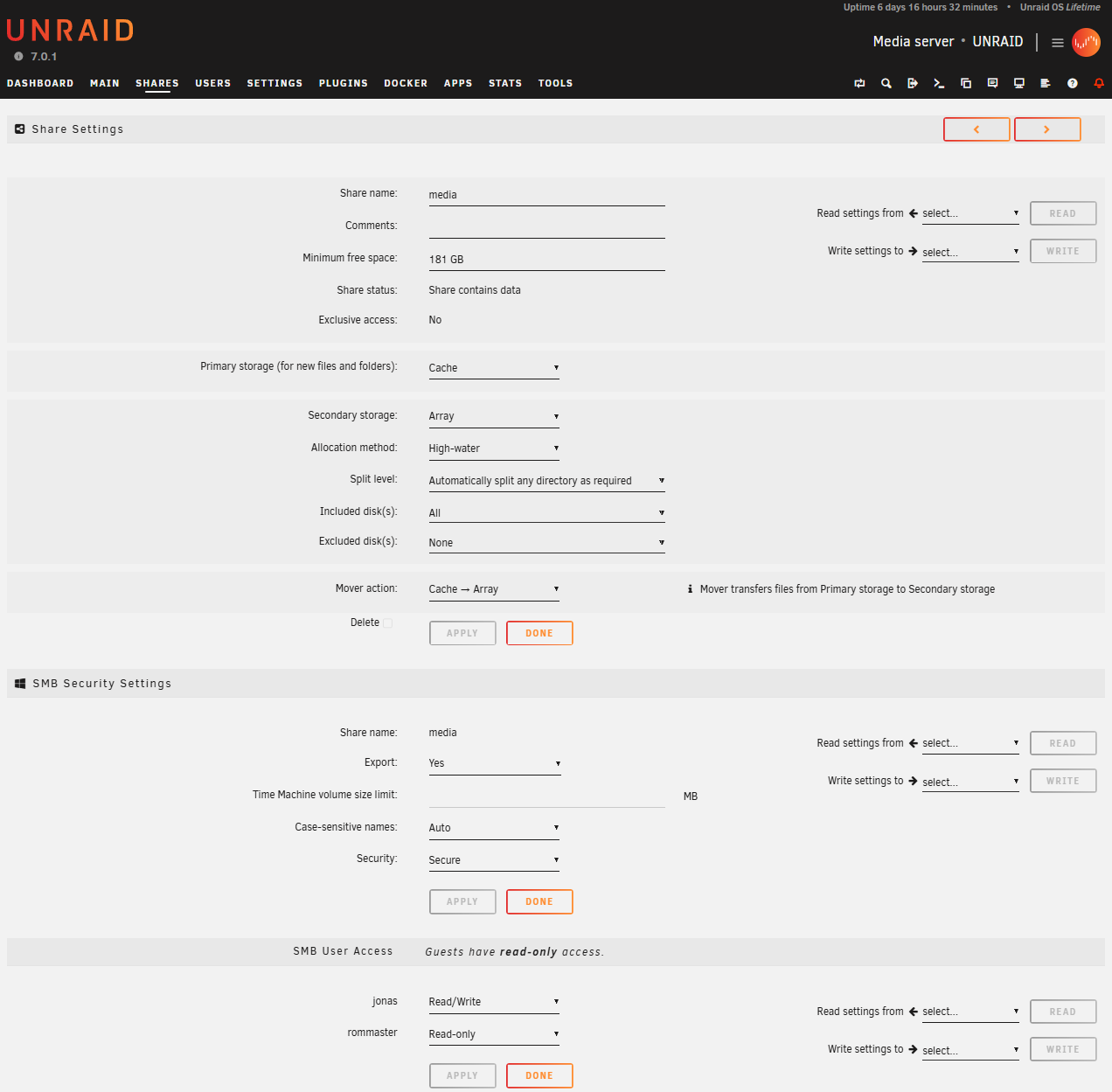

Attached is a screenshot of the settings of this share. Unfortunately I don't understand which setting I need to change.
As mentioned before, this is how it was set up for more than a year and has worked flawlessly. Could you elaborate?
Those settings to reflect the current share cgf, make a dummy change, apply and post new diags.

You appear to have 2 .cfg files with that same (or very similar) name.
Yep, it's a capitalization issue, delete /config/shares/MEDIA.cfg on the flash drive, then reapply the settings for media, and it should then work.
Actually, there was a .cfg file for MEDIA, which is a user share that doesn't actually exist.
And the user share that does exist, media, had no .cfg, so it had default settings.
Correct, when this happens, only one of them can exist in the flash drive, the other one will still appear in the diags, but it's not saved to flash, since it cannot be saved because of being FAT32, I guess it exists in RAM, to fix users just needs to delete the one that exists, and reapply the settings to the other one., and now it will get created.
Okay thanks - just to be clear on how to solve it: i need to shut down the server, remove the usb stick and delete said file, while it is attached to another PC? or is there a way to open some kind of file explorer where I'm able to do that?
Unraid V7 has Dynamix File Manager built-in.
Go to MAIN - Boot Device and click the arrow box icon to the left of flash to browse into the flash drive, and then click on the config folder in that then the shares folder in that, then check the box to the left of MEDIA.cfg and use the DELETE button at the bottom.
Thank you so much! The mover is moving files again :)
