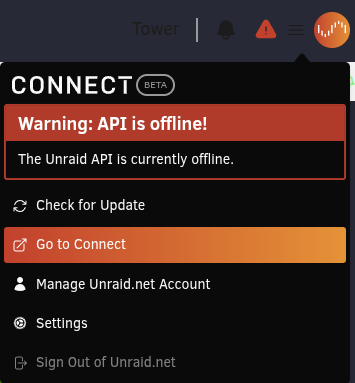

On another note I am getting Warning: API is offline! for Unraid connect.  It is a red triangle on the dashboard

Also just for the full picture this issue started the same time as this also
Likely related, also suggests a connectivity issue.

So just adding more info, as I am unable to do all the switching stuff right this minute, but a couple reboots the unraid connect is working again and I realized that updates to docker apps are working too.  Its just installing a new app
That's strange, and in that case, less likely it's a config issue, possibly a temporary LAN issue with that server, but glad it's resolved.
