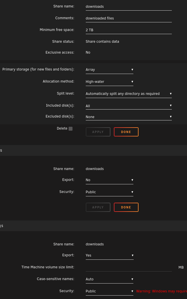

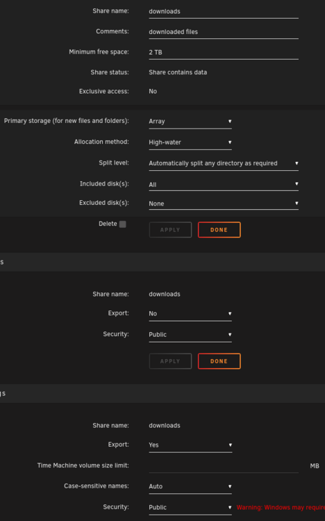

I have configured this share:
When I try to access it from a Kubuntu VM running on Unraid I can only read. As soon as I try to create/move/delete folders/files Dolphin complains with "Access denied". I get the same result using smbclient.
I also get the same result when changing the share to secure and then connect with the same username that has read/write rights and Dolphin also never asks for credentials.

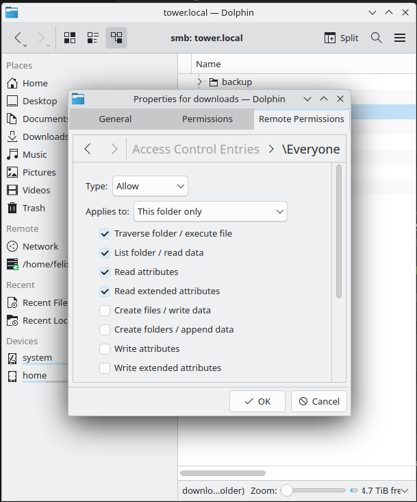

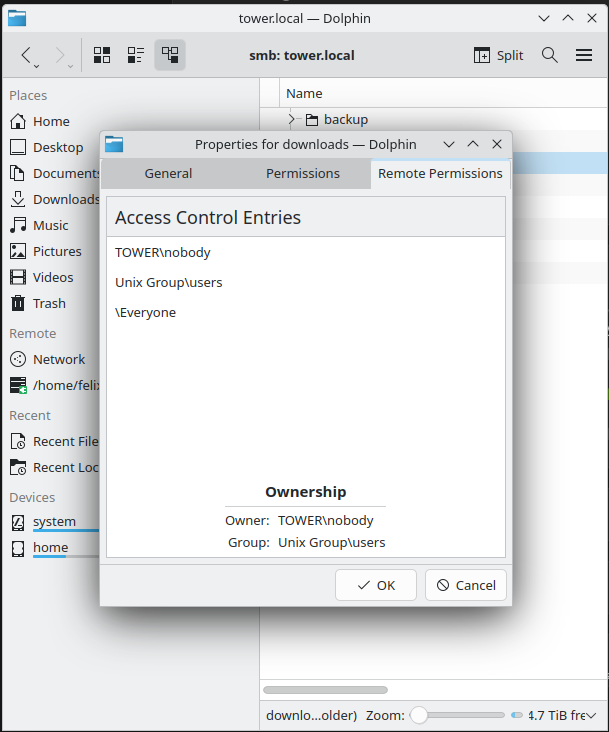

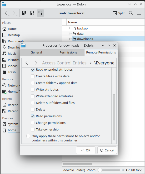

What is going on here? If I check with Dolphin I see this:
How is this possible if the share is set to public?

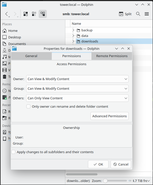

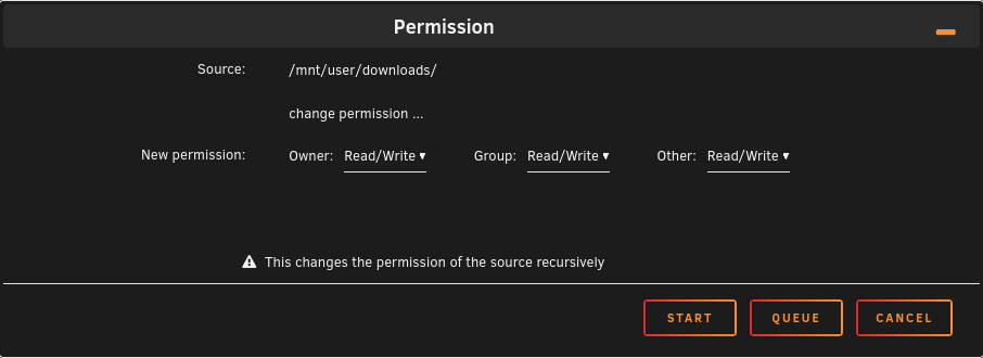

However, after running this:
Permissions look like this now:

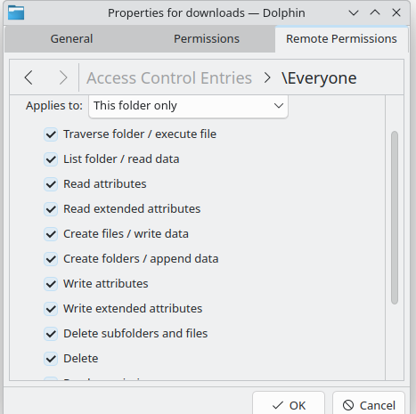

Dolphin is reporting this:
So it's working now.
I just don't understand why. The only difference is the execute flag and still the read/write behavior has changed. Can someone please explain?

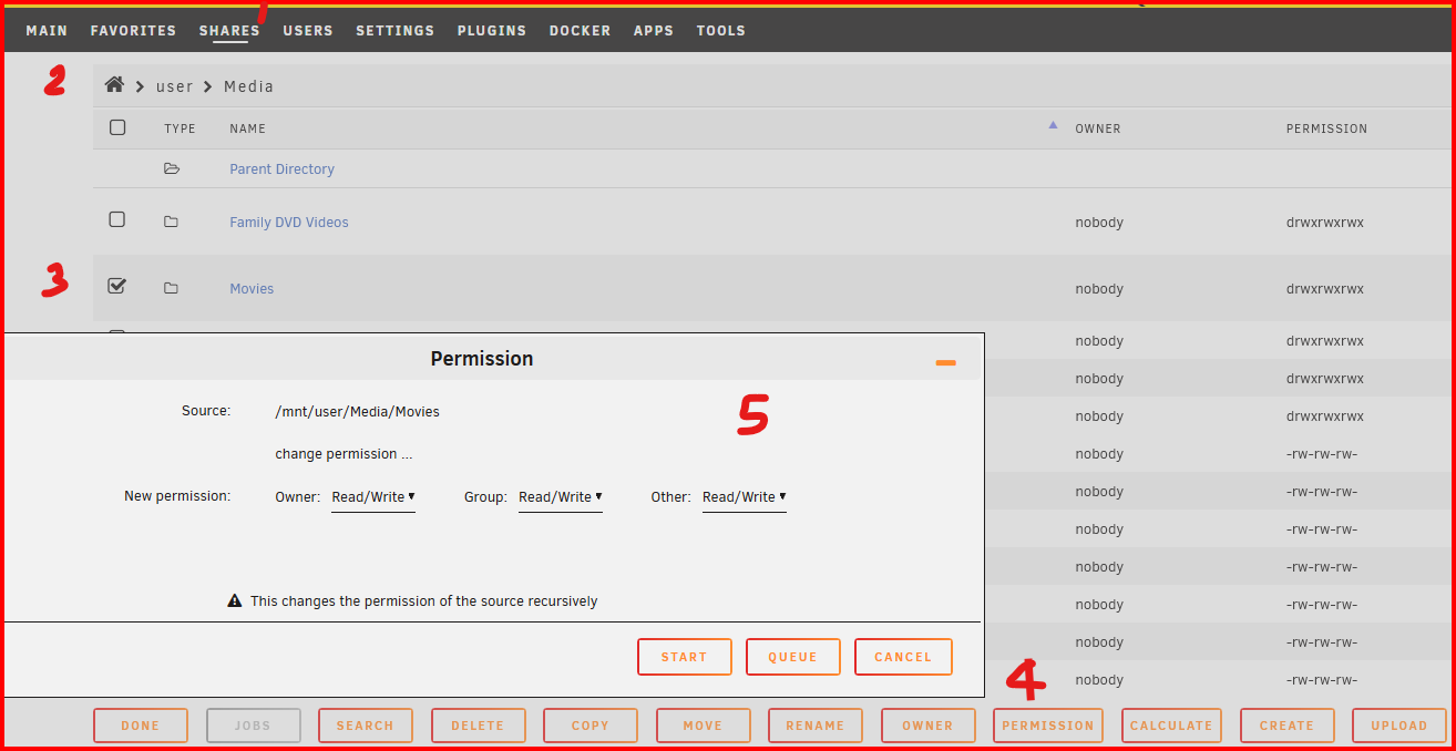

ok so call me a complete moron , but where is this screen in unraid? all i have is new permissions.......
Click on SHARES
Then look under User Shares for the share in which you wan to change the permissions on. Next click on the icon to the left of the share name. These steps are basically indicated on this screenshot:
