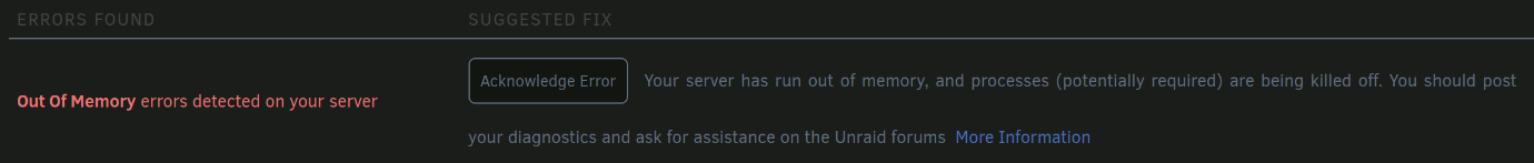

Hello! My server reported an Out of Memory event occurred overnight.
Attached are my diagnostics and if anyone can help me understand why this happened and how to prevent a future occurrence I would appreciate it.
Please let me know if any additional information is needed and thank you in advance for any assistance.

Looks like Sonarr ran away last night, if it happens again limit the memory allowed to the container - reboot to clear the log so FCP stops warning you
