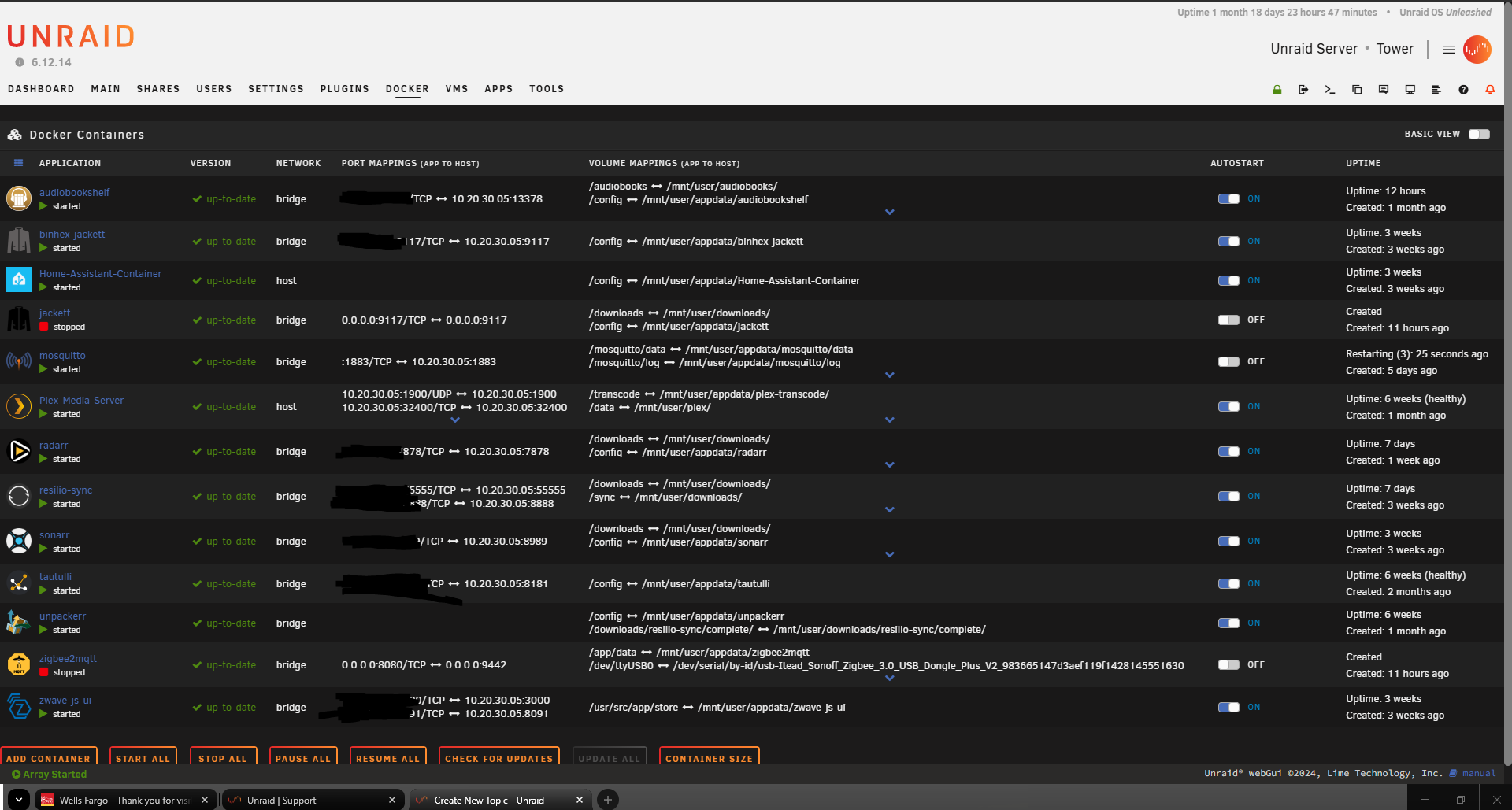

As title suggest, my system is only 6 or 7 months old and I've got some sort of memory leak with something, I'm thinking I configured something wrong in a Docker App but I haven't found it yet.  Its a slow creep, fresh reboot in system Docker will show about 5gb in use (32gb total system RAM). My up-time right now is nearly 50 days and Docker is now showing over 10gb in use. I haven't changed a thing.
The first time I noticed this leak was when some Docker apps stopped working.... logged in after 3 or 4 months uptime and not only did some Apps stop, some were uninstalled completely. Just poof, gone not even listed in the Docker area as started or stopped. After a hard reboot 1 or 2 reappeared as stopped needing updates. The other 1 or 2 I had to reinstall but all my files and settings were still present.  I don't want this to happen again so looking for some assistance.  I've been slowly trying to reboot or update Docker Apps and configs to see if it clears the in use RAM but nothing has helped, I'm out of ideas and need some help.
Diagnostics attached!
OS 6.12.14 Unleashed
32GB Ram
Apps in screenshot, blacked out WAN IP
Storage I've got 2 Arrays; Array (50TB) for Storage & a Cache_nvme Array (1TB) for downloads, appdata, docker apps etc. I tried setting it up so all my Docker apps and their temp files are all saved in that Cache nvme within Appdata but I feel like I suck and didn't do the volume mappings correctly or something
Any feedback or ideas are appreciated. IF there is something I should attach or provide please let me know and I can assist. Thank you for your help in advance if you do end up replying to my post; honestly appreciate it.

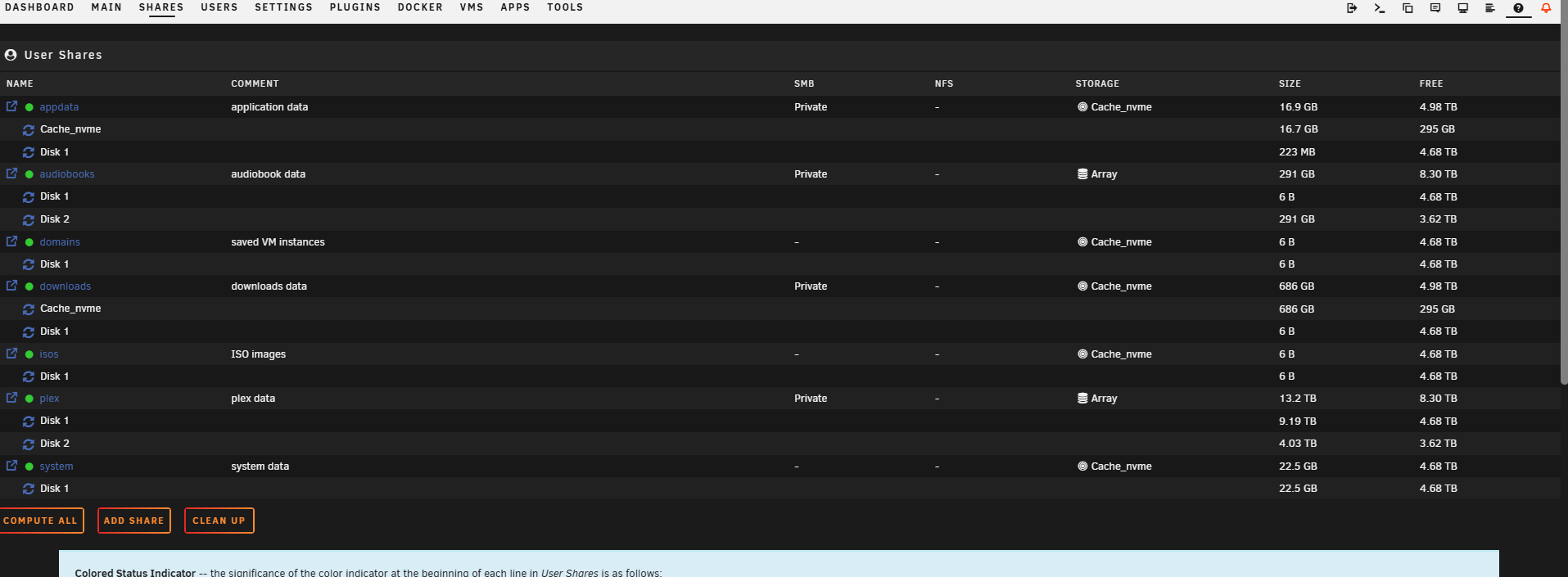

There are some things about your shares that could be better.
https://docs.unraid.net/unraid-os/manual/shares/user-shares/#default-shares
Ideally, these shares would have all files on cache or other pool, with nothing on the array, so Docker/VM performance won't be impacted by slower array reads and especially writes, and so array disks can spin down since these files are always open.
appdata                           shareUseCache="only"    # Share exists on cache_nvme, disk1
domains                           shareUseCache="only"    # Share exists on disk1
d-------s                         shareUseCache="only"    # Share exists on cache_nvme, disk1
isos                              shareUseCache="only"    # Share exists on disk1
system                            shareUseCache="only"    # Share exists on disk1
These shares are configured to only put files on cache_nvme. As you can see, they have files on the array, and they won't be moved to cache_nvme since they have no Mover action.
All of these are discussed in that link I gave, except...
Your downloads share (if that is its name). Seems to me you would want that written to cache_nvme and moved to the array. What do you want for that share?

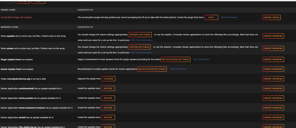

You should install Fix Common Problems. It would be telling you that your shares locations do not match their settings.

FixProblems - Downloaded and going through a few of the things. You are correct it shows the Appdata shares thing you talked about.     image.thumb.png.b26a0bae2ecd7cedb11e0ffeda684008.png

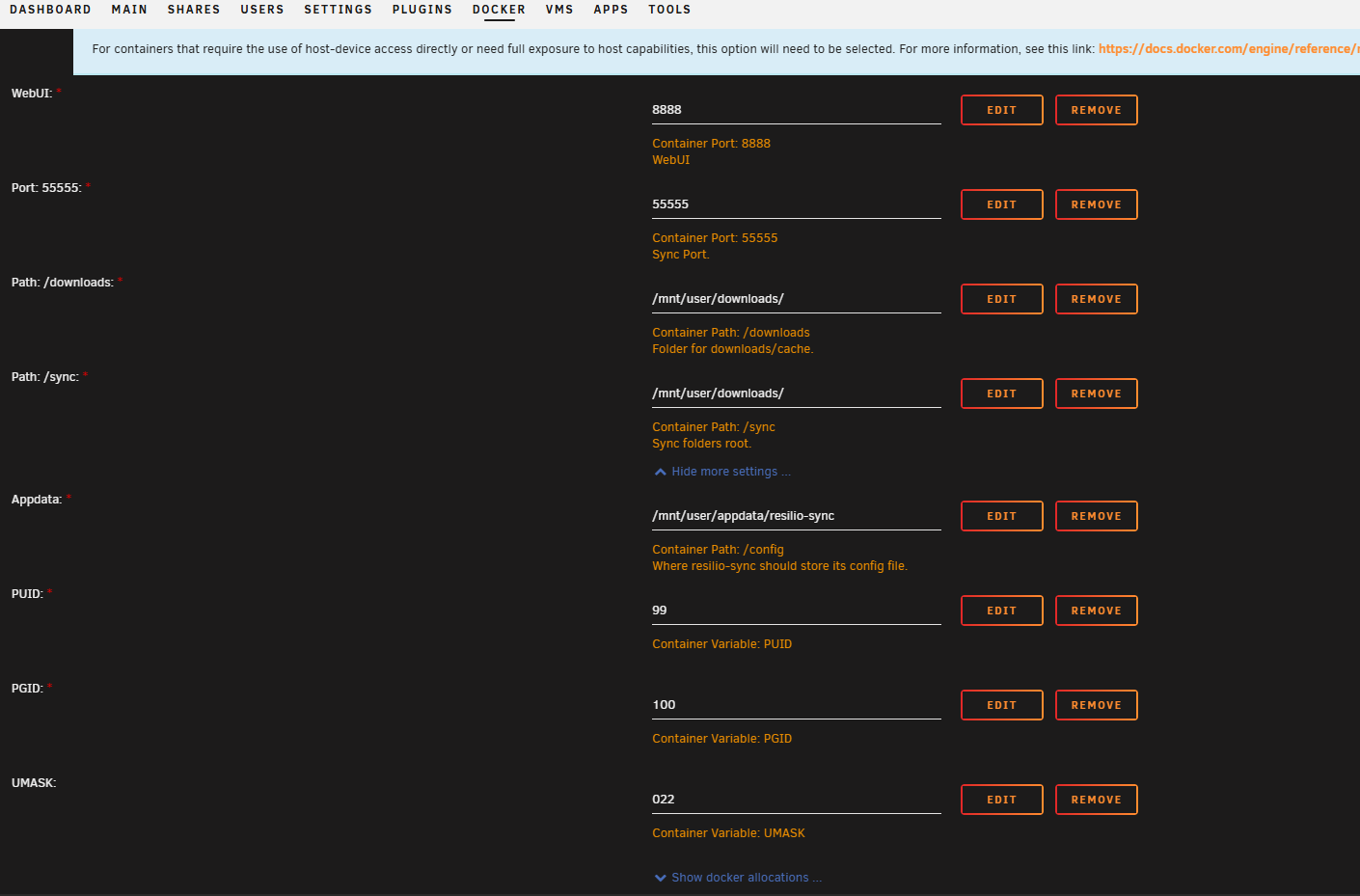

Here is my Resilio app settings if you could take a look or point out what I've done wrong:

I don't use Resilio, but I think we can deal with a lot of this more generally.

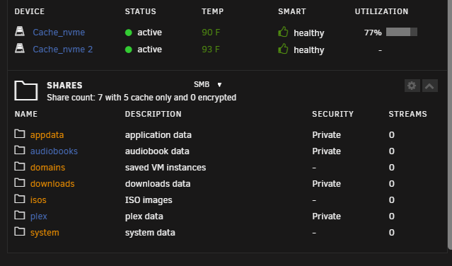

You said "Downloads", but as you can see in your screenshot, the share is really named "downloads". You need to be careful with that, linux is case-sensitive, so "Downloads" and "downloads" are different.
As mentioned, those "default" shares files are always open. Nothing can move open files.
Before we can move those, we need to make sure all of those files are not open:
Go to Settings - Docker and disable Docker.
Go to Settings - VM Manager and disable VMs.
Leave them disabled until we get everything where it belongs.
Then post new diagnostics so I can make sure I have the latest information.

You have a few .cfg files in config/shares that don't correspond to any user shares. Probably you created some shares (perhaps accidentally) and then deleted them.
Go to the User Shares page and use the CLEAN UP button to clean those up (and clean up your diagnostics). That can sometimes also help if a share setting doesn't seem to be working, since they may be loading from those instead if the names are similar (usually upper/lowercase mismatch).
Set downloads share to
Primary:cache_nvme; Secondary:array; Mover action:cache_nvme->array.
After we get that one moved we can change it so it only puts files on the array.
Set appdata, domains, isos, system shares to
Primary:cache_nvme; Secondary:array; Mover action:array->cache_nvme.
