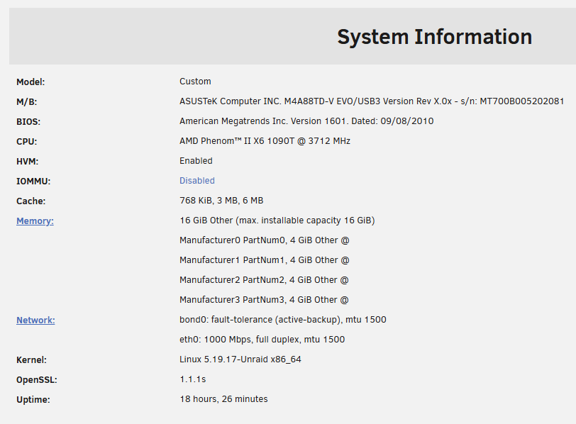

The other day I opened up unraid and found one of my drives turned off and had an "x" by the name. My initial find was that I had several "UDMA CRC error count" about 46. This leads me to believe this specific error caused my drive to become disabled; as that was the only issue I found at that time. I also completed an extended SMART test and it came back with no errors. (attaching report)
When this happened I turned off the system and swapped the SATA cable with the issue drive. After rebooting the system I started getting UDMA CRC errors for two of my other drives. Now this is leading me to believe something else may be wrong.

Hardware is pretty old, see png for more info.
Please let me know if you need more information about the system...
