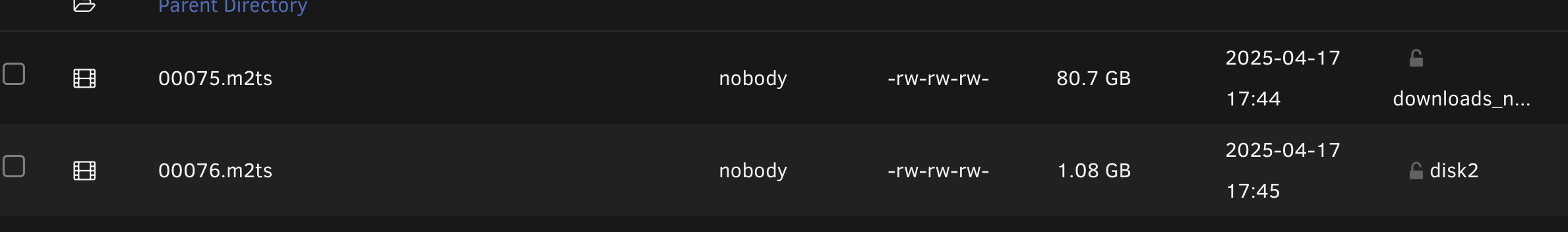

as you can see from screenshot the largest file is on my NVME and will not move to HD, even if I try manual with Unraid's file explorer.

ok update:
transferred to disk 3 and worked, this just not explain why not write to disk 2 with over 400GB of free space, no way leaving that amount untouched.
00075.m2ts 80.7gb
Media/movies
It should go to disk2 based on the settings that you were using, when you have another large file to move, enable the mover logging and try again, then post new diags if it fails, but I would recommend leaving at least 100 or 200GB free on the disk.
