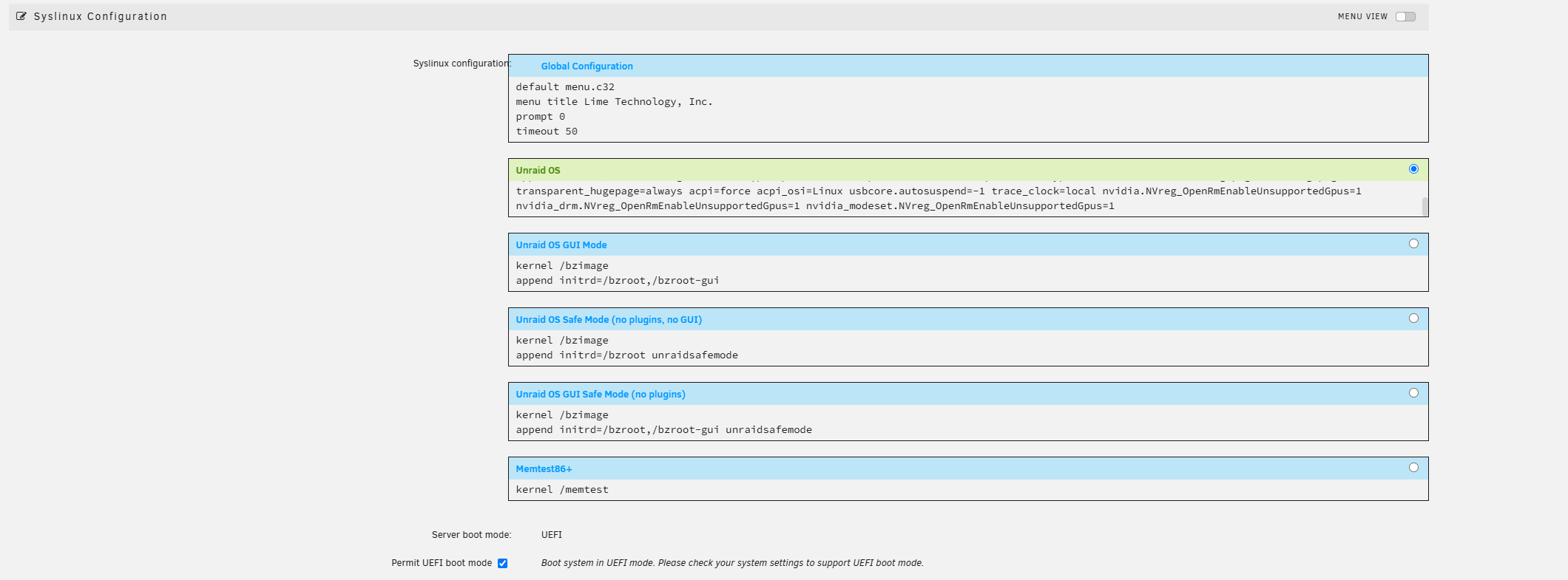

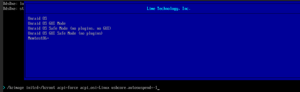

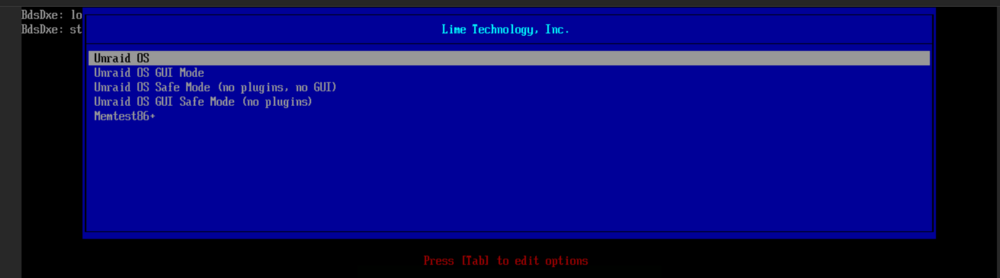

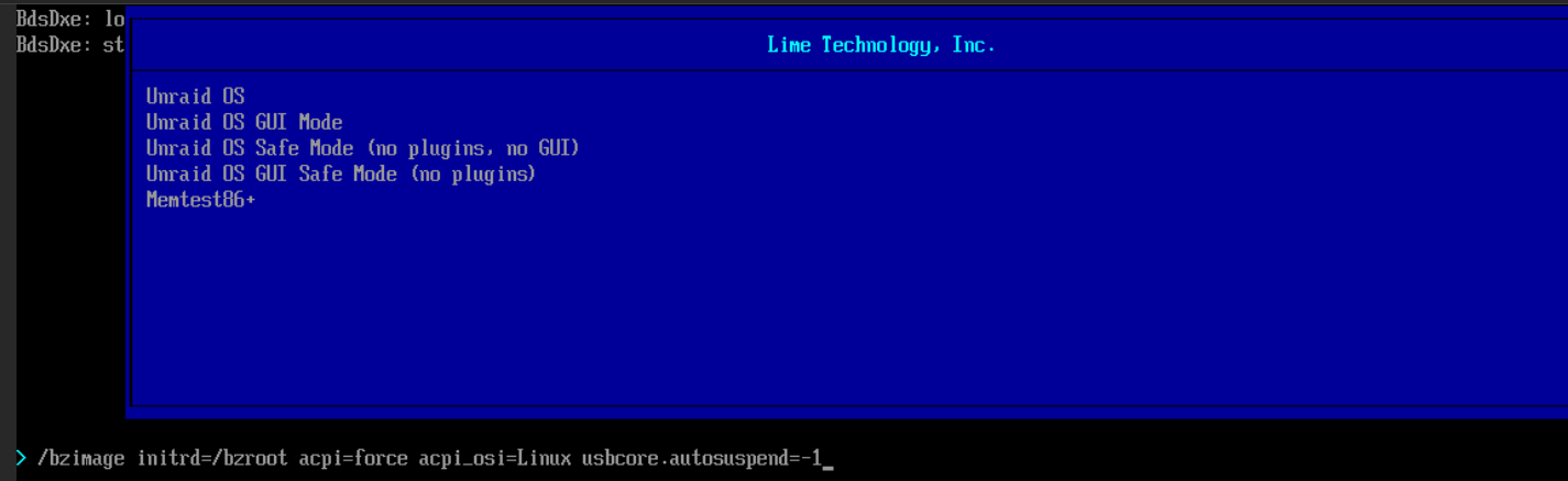

at the grub screen you can edit the unraid boot line you can try adational grub syslinux commands
use "Tab" key and edit the OS boot options.
Examples to try:
acpi=force acpi_osi=Linux usbcore.autosuspend=-1
so after /bzroot ...linux grub sysliux commands...
to disable the usb from entering a power sleep mode and to for linux to use the OSI linux ....
you can even try noapic option at the grub boot menu.
Later once unraid has booted on your platform you can set the grub options at every boot...
