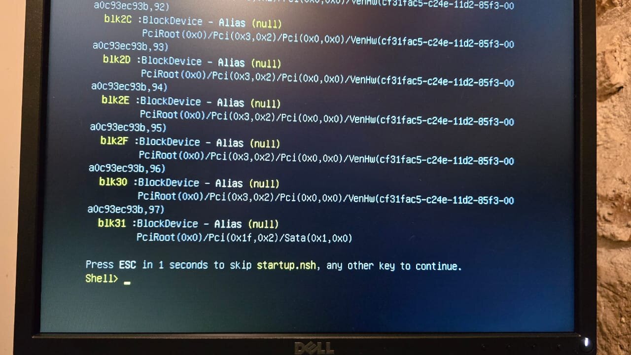

I woke up this morning finding my unraid server unresposive. The web ui was not accessible. I could ping the server but when I tried to connect to it through ssh it gave me a message saying that connection was refused on port 22. I also had no console. Through IPMI I reset the system and then it could not boot! During the boot procedure the HBA was recognizing all my HDD's but always ends up in this state.
Since the HBA sees all disks, and assuming that even if there was a problem with the HBA the server would boot but without being able to see the disks, I assume that there is a problem with the USB boot drive.
What do you think ?

That shows the server booting to the bult-in UEFI shell, see if the flash drive is still being detected and is the first boot device.
The flash drive looks like it is detected since it appears in the boot options and is the default (only one) boot option. So it seems that the problem lies with the flash drive itself.
