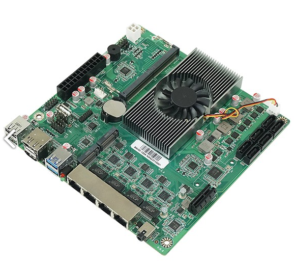

Completely fresh Unraid (7.0.1) user here - just built my first diy NAS with this NAS mobo after wanting to expand past my Synology DS413 and reusing my 4tb drives from it:
https://www.bkipc.com/en/product/1264-NAS-MB.html

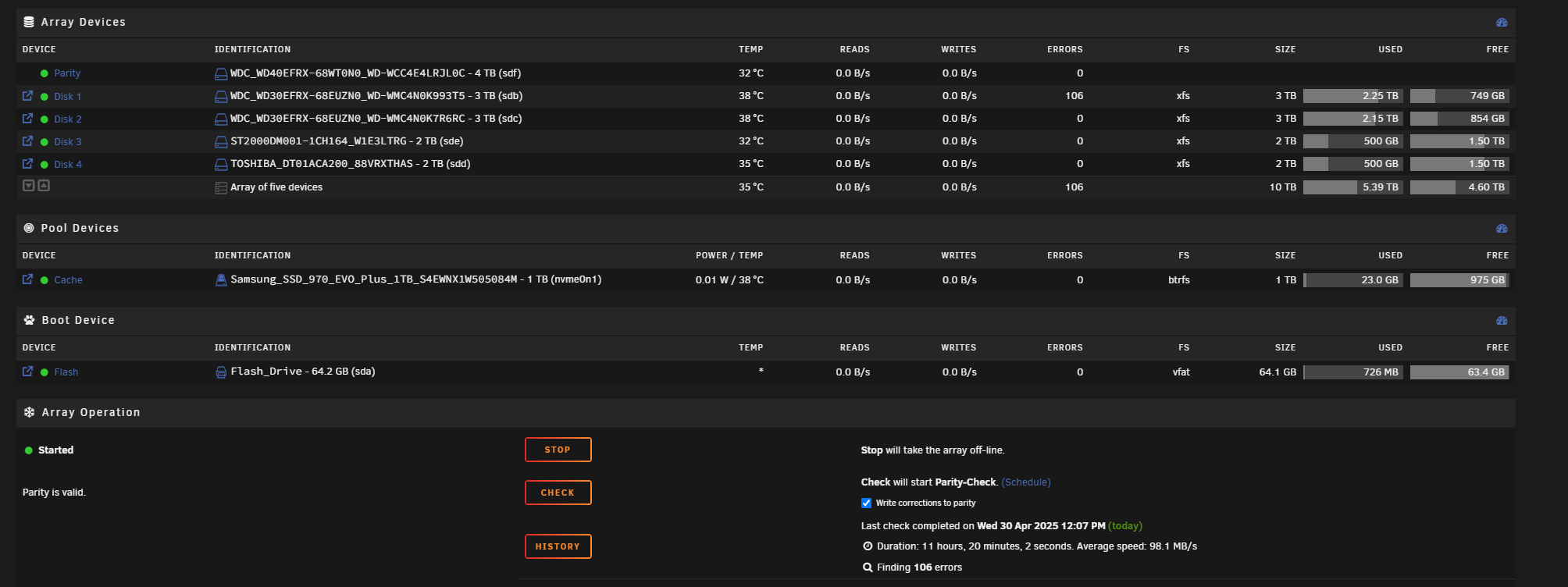

I then powered  down the drive, binned the faulty ZZ drive and threw in the next 4tb drive - parity op began again and completed this time after 10 or so hours. This is when i noticed the read errors in the screenshot above.
So i figured now with a parity drive I can upgrade the drive with the read errors to the next 4tb drive pulled from the DS413.

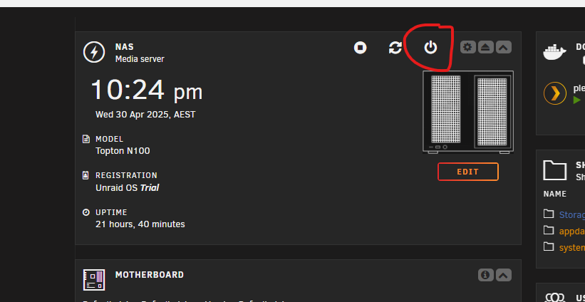

I shutdown the server by clicking the power button in Unraid:
Removed the drive with read errors and inserted a 4tb drive in it's place - However, when i powered back on, my array was gone , the parity drive was  unallocated and unraid was showing that it was looking for the "ZZ" drive in it's place.
and because the parity drive was gone everything was gone and unmounted. So I powered down again, replugged the 3tb drive with read errors back in and rebooted. Once it was back , the parity drive  was gone again and it was looking for the ZZ drive. But I was able to select the 4tb drive that is in there but the parity was gone. It started from scratch again.

I've attached the diagnostics aswell, are there any other drives in the array i should be concerned about?

Disk1 does have 3 pending sectors, but that wouldn't cause that many read errors. And it has passed extended self-test. If everything else was working well I might recommend rebuilding disk1 to see if those pending sectors would become reallocated.
Also syslog says multiple disk errors, but disk1 is the only one logged. SMART for other disks looks fine.
The part where it is forgetting the new parity assignment sounds like a flash drive problem, since that is where the assignments (and all the rest of your configuration) is kept. But I don't see any other indicator of flash problem.
Your array assignments are in config/super.dat, which is not exactly human-readable, but it looks like it currently has the correct parity assignment in it, so maybe it will stick this time.
You might try checking all connections, SATA and power, both ends, including power splitters if you have any (probably not with so few drives). Maybe even replace SATA cables.

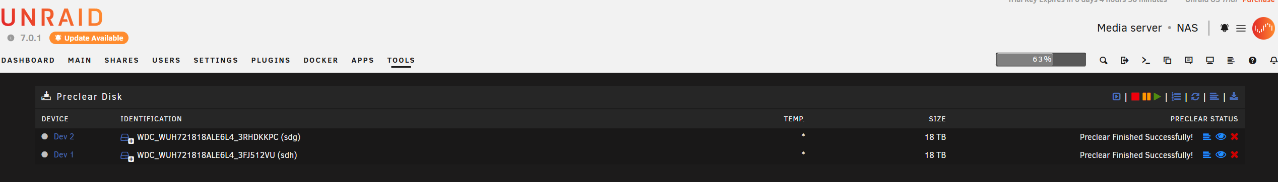

ok - extended smart tests done and preclears just finished!
Now if I'm going with option 1 of dropping my parity disk do i just physically disconnect the parity drive from the machine after power down and on power up I will have the ability to assign one of the 18tb drives in it's place? Then wait for rebuild and do the same with disk1?
