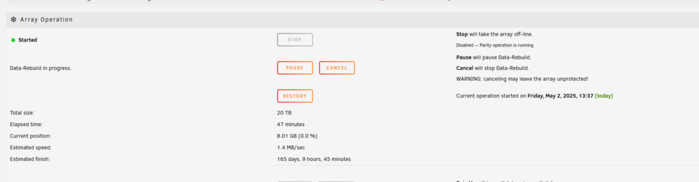

Data rebuild is running really, really slow. I've attached screenshot.  It's a 20 TB drive so I know it will take forever, but the data transfers are extremely slow and I'm not seeing any read/writes going on or errors.
