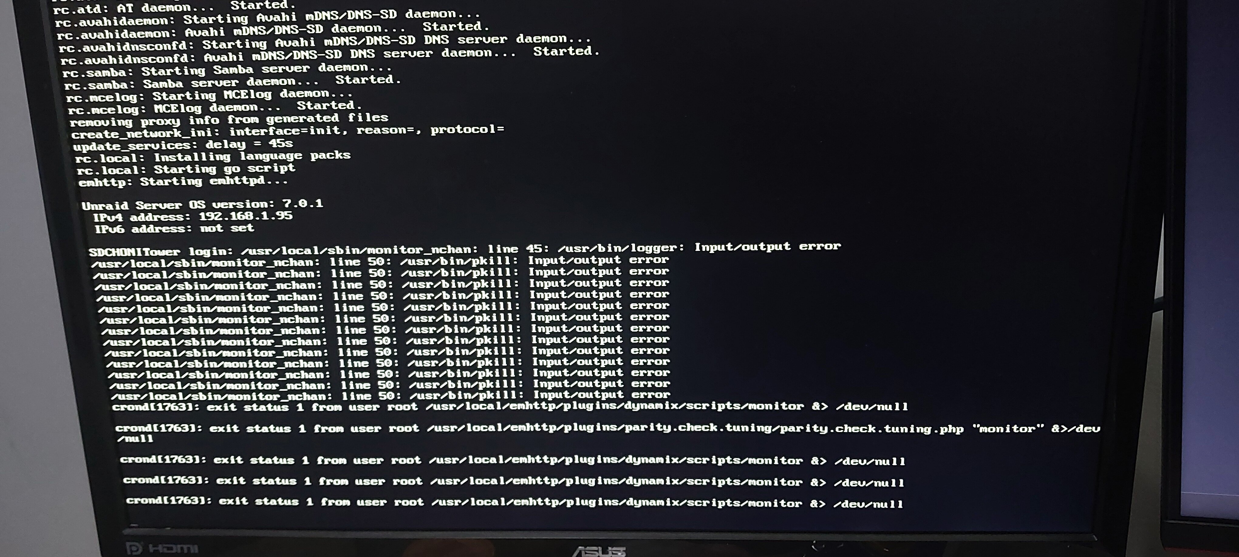

When I go to back up my windows computer using Macrium Reflect Unraid will stop responding after ~2.5hrs. When I press the power button on my unraid server the display outputs the below (sorry for the picture. I need to buy a DVI to HDMI adapater and start running this through a capture card....) and does not shut down unless I do a forced shutdown. When it reboots, my bios doesn't see the flash drive unless I reboot the computer again. After rebooting, it successfully completes a parity check with 0 errors (this is the time this has happened).

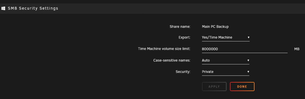

Could this be because I have the Volume Size Limit set to 8TB in SMB Security Settings?
I wanted to have a 1-2 copies for each backup, but didn't want it taking up all my drive space.
Currently the share is 7.89TB
You are using Time Machine settings, you mentioned Macrium? The floor should be set to around twice the largest file you expect to copy to that share, but that should not cause the server to crash.
It's 8x, so I should be good there.
I've limited the share to 1 drive. I'll try running it again and will report back (with log files) if it crashes again.

It will work as long as there's enough space on the disks.
That's not the same as using a disk share.
Used a new USB for my unraid drive and that solved the issue. I think it got turned off in a thunderstorm or something, which probably caused some corruption, and a fresh install (using a backup) fixed it.
