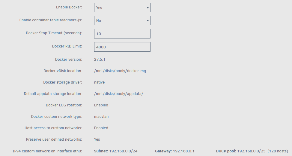

I have updated to 7.1.2, and I am not able to communicate with my containers anymore between my host and docker network.
I can read logs and exec into containers fine.
Docker settings:
I use macvlan
Host access to custom networks is Enabled
Preserve user defined networks is still Yes
I see this note: https://docs.unraid.net/unraid-os/release-notes/7.0.0/#issues-using-docker-custom-networks
I attempted to set `DHCP pool: 192.168.0.0/25  (128 hosts)`, but I am still not able to access anything on my docker network from my host network.
Containers of network type host are working fine.
I have attached my diagnostics.
My docker network still looks as I expect/is bridged to my host.

23 hours ago, JorgeB said:
Enable bridging for eth0, then try again.
Enabling bridging did work (I thought that was on the whole time), I could set ipvlan. Starting docker with ipvlan set was still not accessible from my host network, setting it back to macvlan also didn't fix my access.
Since I thought bridging was enabled before now, I now wonder if other network settings might be different than what I originally set them to. I also wonder if something with tailscale could be causing this (these are not tailscale enabled containers, but I know some changes happened between host and tailscale networking recently)
Edited by paperblankets
