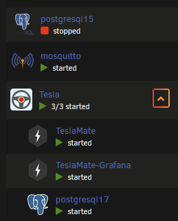

Upgrading PostgreSQL v15 ->v17 (for TeslaMate)
Teslamate recently made a breaking change requiring postgresql 16+ and when I tried upgrading from v15 to v17, i ran into some issues,
i installed postgresql 17 container via CA store, and "upgraded" from 15 to 17 using the commands below, referencing this process for immich and this video by the same author. both specific to unraid (but for earlier postgres versions)
(on postgresql 15 container, click console)
pg_dump -U DBUSERNAME -h IPADDRESS -p PORT -fc -f /var/lib/postgresql/data/teslamate.dump DBNAME
(on postgresql 17 container, click console)
pg_restore -U DBUSERNAME -h IPADDRESS -p PORT -d DBNAME /var/lib/postgresql/data/teslamate.dump

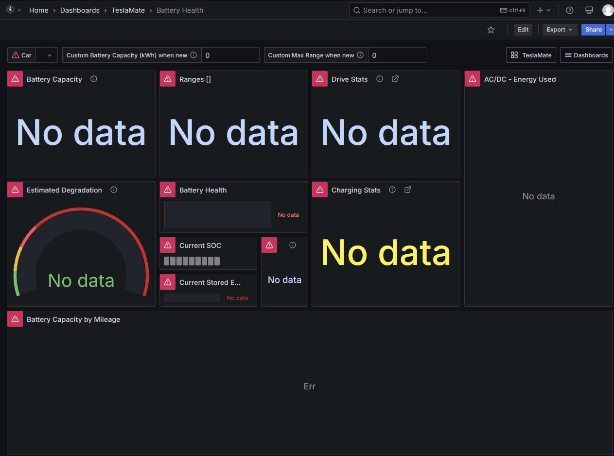

I also have integration via MQTT on Home Assistant, and can see certain data that way, and teslamate webgui also seems to be loading fine. However, when trying to access any dashboards via grafana, several errors show up in the postgres logs around "invalid input syntax for type json" and also "syntax error at or near "AND"" errors"
I've attached what the log of the postgresql 17 container looks like when accessing grafana dashboards (uploading as text to avoid posting extremely long comment)

however, i am still getting no data showing in grafana, so i'm still where i started unfortunately

@bmartino1 once again thank you, I can't say this enough. You've helped me think through how this works and examine what may have been missing, and based on what you said I found the issue was twofold. First off, for context, the teslamate install on unraid is made of of 4 containers:
  • MQTT
  • TeslaMate
  • TeslaMate-Grafana
  • PostgreSQL
What you said helped me re-asses that I should check configuration for each, not just postgresql 17/15 container. So my issues were:
  1. TeslaMate-Grafana container was not pointing to right database name
    • I had renamed database from default name "postgres" to new name "teslamate" to be more specific
    • this is changed in the container config, click container then edit
    • this is purely user error and likely wouldn't happen to others
  2. TeslaMate-Grafana appdata, which is points to appdata/TeslaMate/grafana had issues
    • I'm not sure exactly what, but assuming that my data was safe in the database, I deleted this appdata folder and reconfigured grafana
    • this fixed my issue and may also happen to others

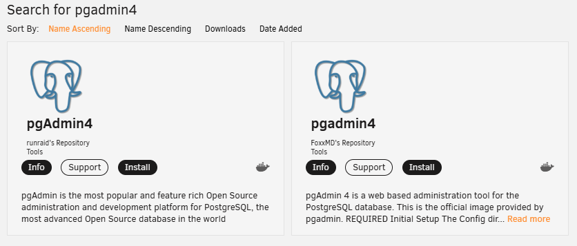

Ok so I did abit of a cheat, as I have been using PGAdmin4 for another project and to keep backups I thought to just go and use that and ended up being alot simpler to connect, backup and do a clean restore into the new system,

I would recommend it..
It is a nicer interface to interface with Postgres. Unless your comfortable setting docker variable paths and running postgress commands to touch and edit the database.
