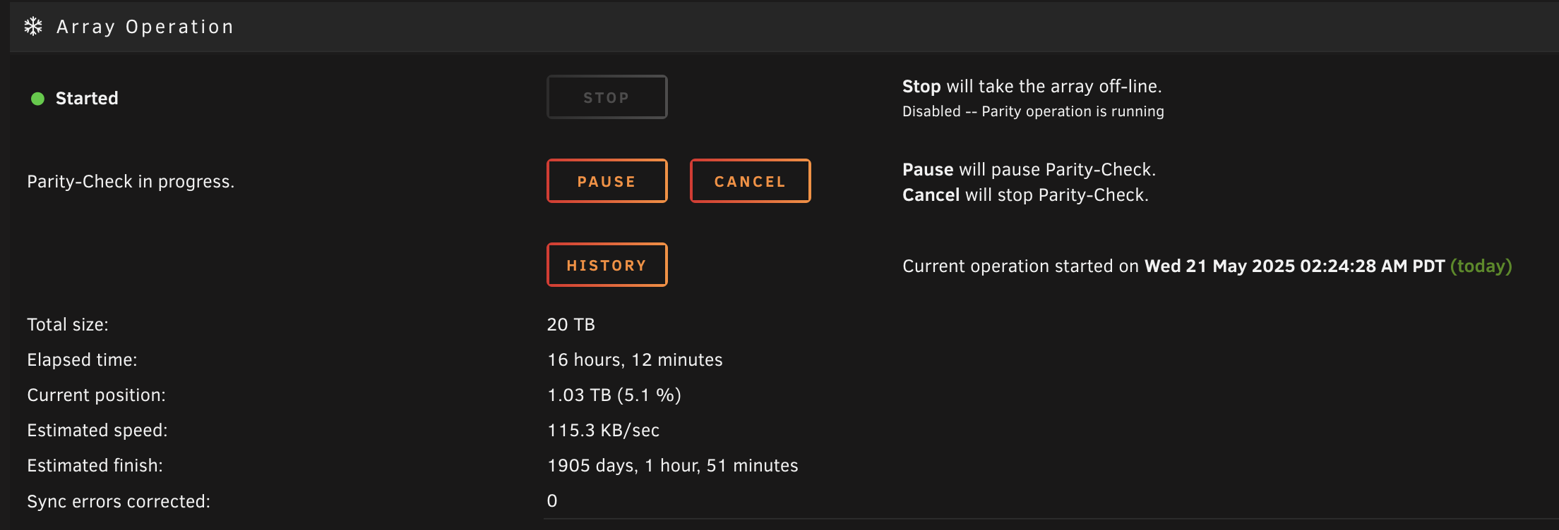

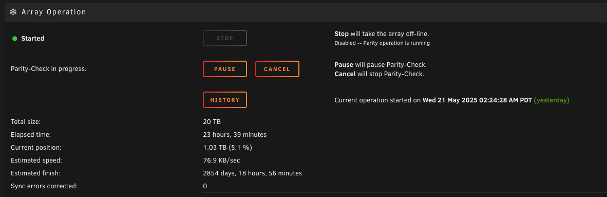

Does the memtest86 help diagnose the specific issues? Also, I'm noticing on certain parity runs that the speeds are absymally low, despite nothing aberrant coming up on SMART checks or DiskSpeed plugin, which benchmarks all the HDD drives at sufficient speeds. Parity check operated perfectly fine at the beginning of April, as they had always done. Not sure if this is a related issue or whether a separate problem...

I attempted to hit cancel on the below screenshot state. Got the indeterminate progress indicator, but it never cancelled and didn't disappear until I clicked a different tab at the top and returned back to main. And still looks like it hasn't cancelled the parity check. Downloaded the syslog file and updated diagnostics at this point, which are attached below.

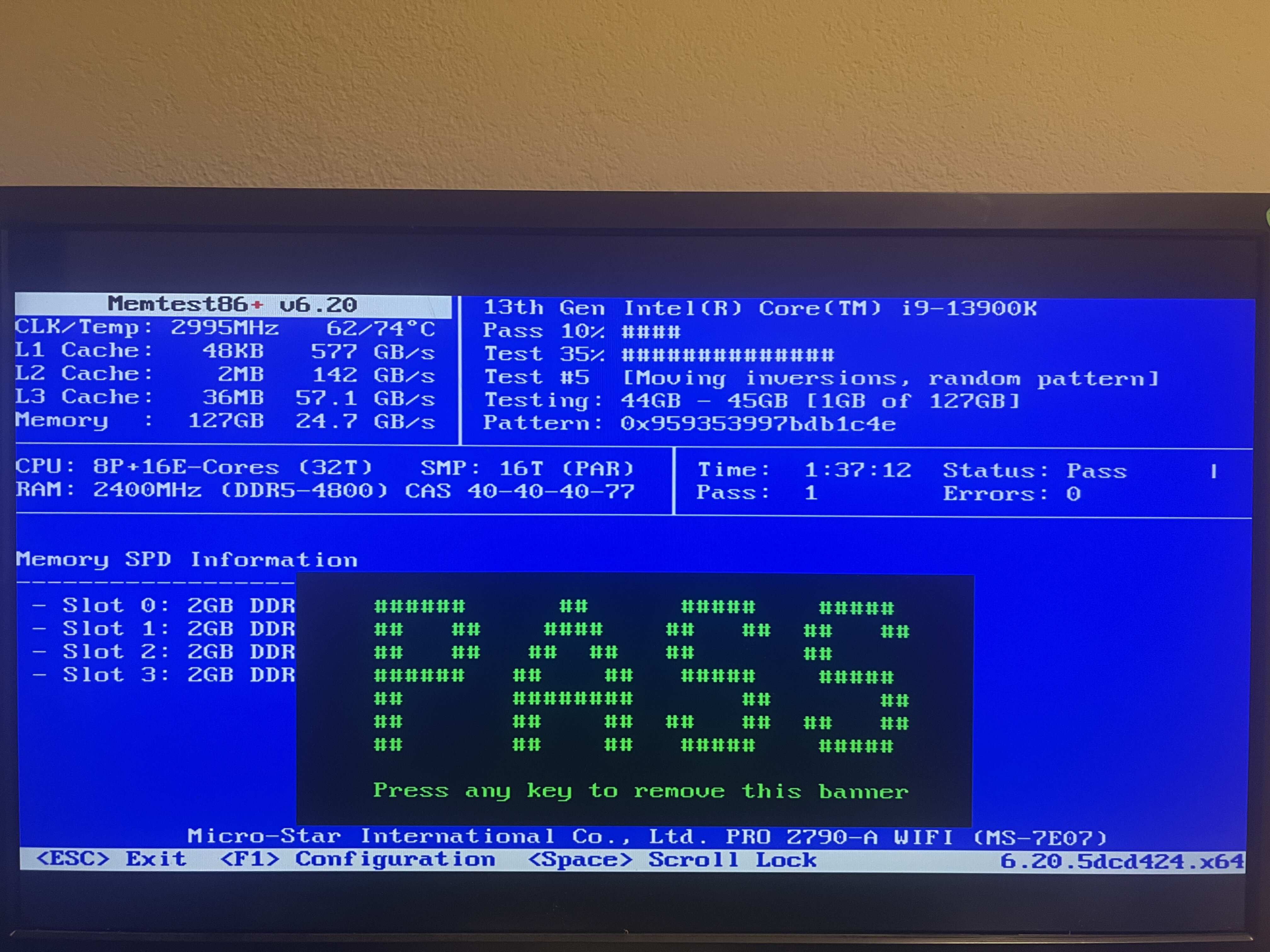

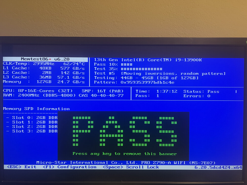

I ran memtest86+ v6.20, and it seemed to pass as in the picture down below. Didn't realize that there were Intel 13th/14th gen CPU issues - I also went ahead and updated the motherboard BIOS to the latest stable firmware release. What data from those log files should I send Intel to get the chip RMA'd as I've never done anything like this before? TIA!
