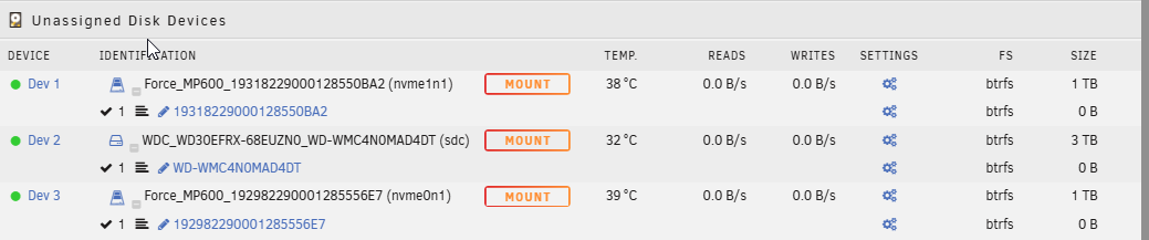

    • i then left the cache drives unassigned and checked if i could access the data of the drive via unassigned plugin which was promising i was able to mount nvme1 and saw that the data was accessable, but i had no disk mounted to copy it
    • i unmounted nvme1
    • i turned of Docker and VM support in the settings.(referring to the FAQ)
    • i started the array
    • i tried top mount nvme1 which wasn't available anymore as an option in the Main overvriew the mount button was grayed out.
    • as a fallback i then mounted nvme0 and used the unassigned Disk Plugin to copy all contents to a backup share in the array. that took a while

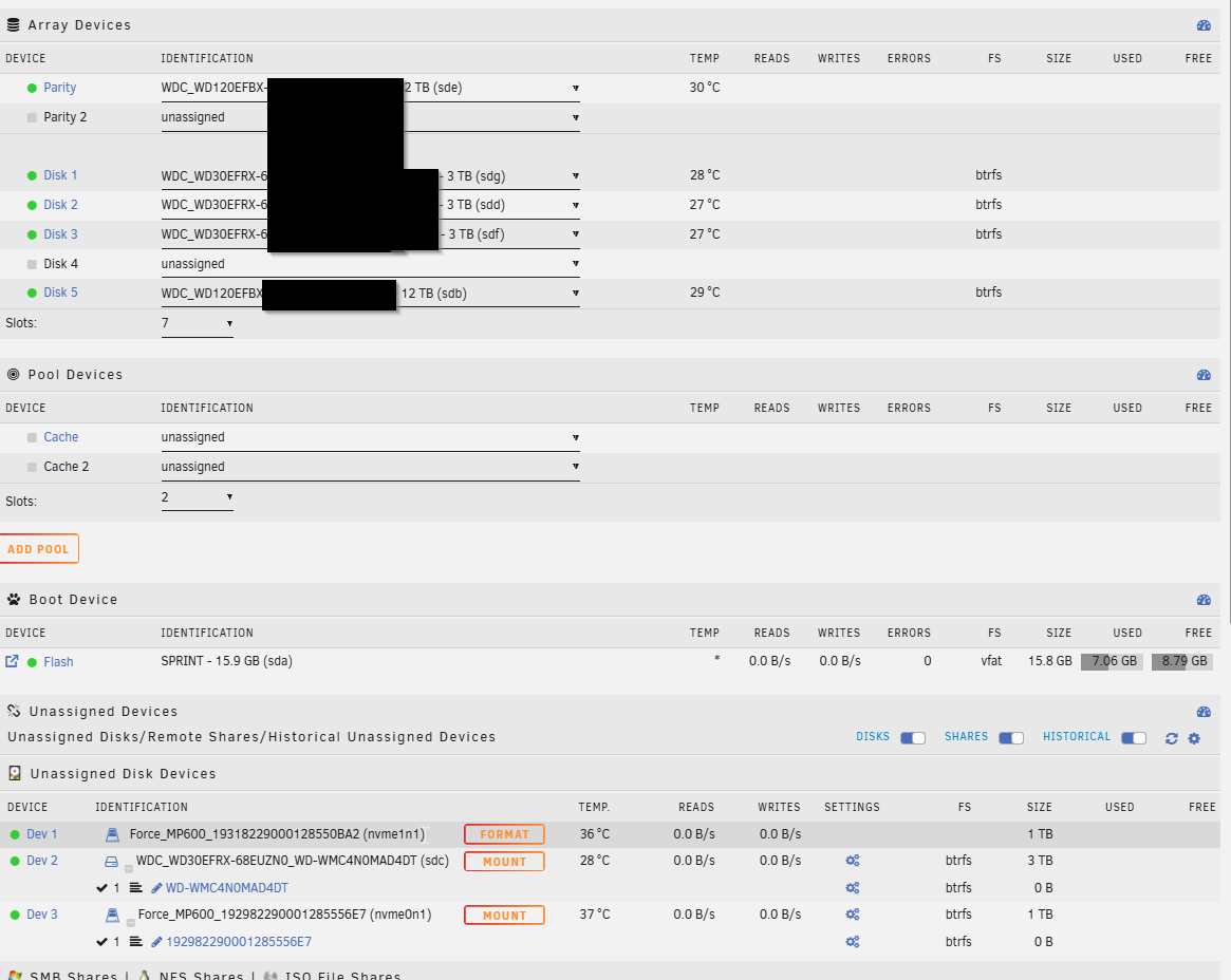

the previous *** Some devices missing is gone.
also the webui shows now(array is still stopped):
Edited by Haube
Now click the first cache slot on the GUI and then remove pool, then back on main, add a new pool with the same name and 2 slots, assign both devices and start the array, see if the pool mounts, any errors post new diags, but if the first device causes errors, it may be better to remove it and use only the other one, assuming it was really a mirror.
So new Cache Pool,
  • disks showed up with blue square in the ui.
  • started the array. It mounted!
  • now i use the mover to evac the cache
  • then normal procedure replace hardware and copy stuff back on the then again new cache
