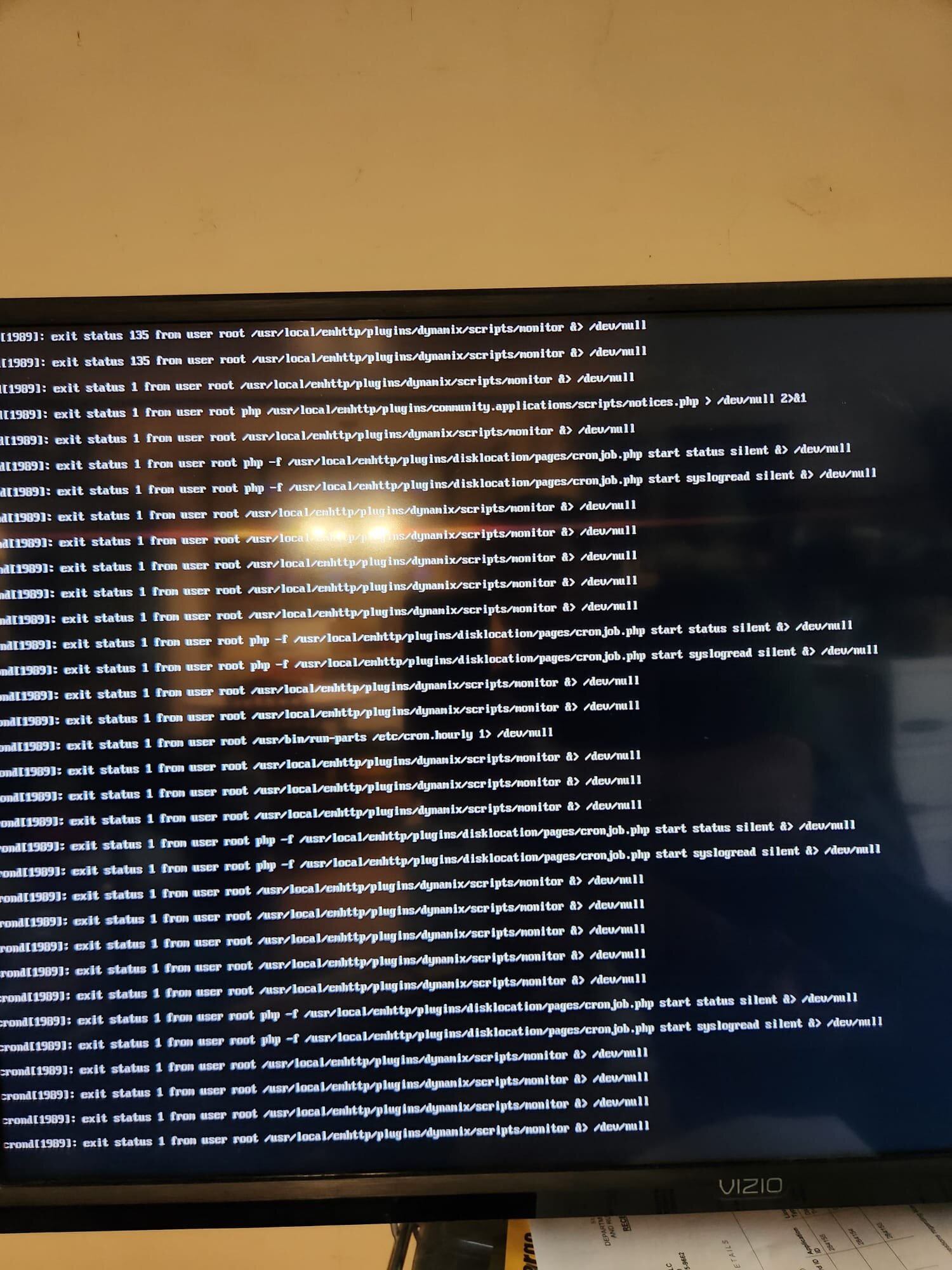

My server will suddenly just stop responding. Sometimes it runs for days, sometimes just an hour.
I checked all internal connections, installed new memory, and swapped to a new USB drive.
I also attached a picture of what's on the screen when its locked up.

Don't see anything crash related log, do see the NIC link going down:
May 22 03:01:21 SchmittNAS kernel: igc 0000:08:00.0 eth0: NIC Link is Down
Maybe you thought the server crashed becuase of that?
@03:00 my UDM PRO updated software, then rebooted. I am at a loss, I can't find anything wrong. I even went back to one of my older 6. back ups and it does the same thing.
Typically, when there's nothing else logged, it's a hardware issue, if you have multiple sticks try using the server with just one, if the same try with a different one, that will basically rule out bad RAM.
I replaced The Ram with Brand new. I am starting to think its a motherboard issue. This server has run perfectly until recently. I thought it was the flash drive because I had a flash drive unresponsive error. so I changed that and it was better for a few days. The I changed the RAM and it seemed better... Now its back to doing it again.
Update:
I upgraded to 7.0.1 and so far its stable and running.
