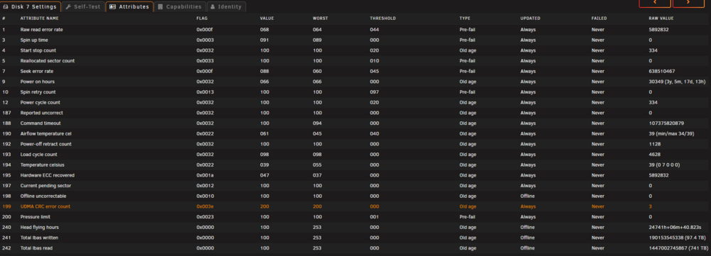

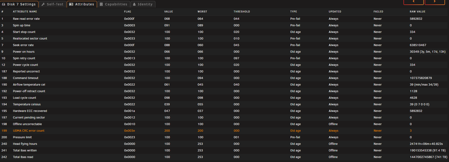

Hardware or cable, Why are my 3 year old Exos drives failing? Parity started and of course a drive fails.
I have 4 of these, and 2 of them have already failed. Is this a hardware fail? Screen shot and diagnastics attatched. schmittnas-diagnostics-20260601-1224.zip

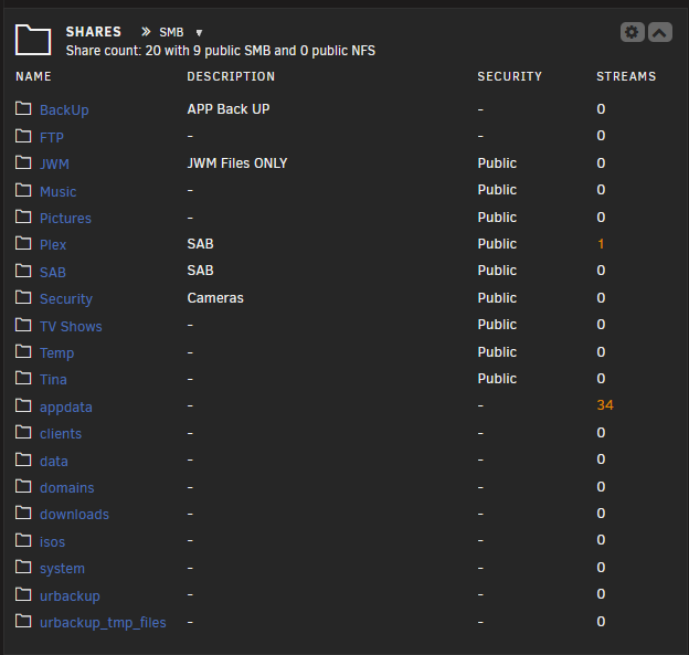

App Data Backup is creating a share, and it has streams and app data doesen't
On the right side of the image where it says streams. here is screenshot after I moved the backup share and restarted docker. The streams from the dockers are now running on the appdata share where they are supposed to be. In the other image they are running off the backup share.

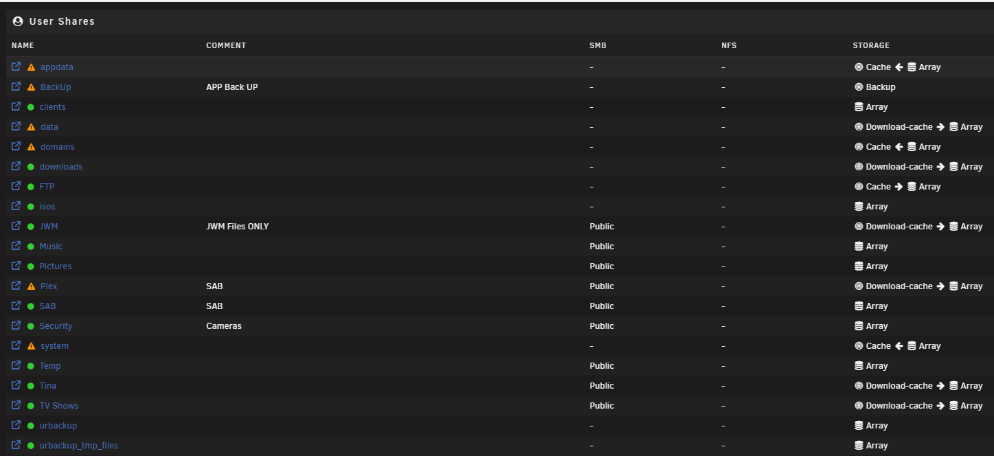

That's from the Dashboard. OK so I see what you mean, I originally had a folder in the pool backup. When I lost the disk and you helped me through getting back online I remember an error and I changed the location in app backup from backup/backup to just backup. that explains that part.

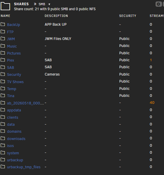

I have no idea why app data backup is creating a share. it is set to back up to a pool called back up. Today I looked and the back up has 40 streams connected to it and appdata has none. Any idea what the heck is going on?
