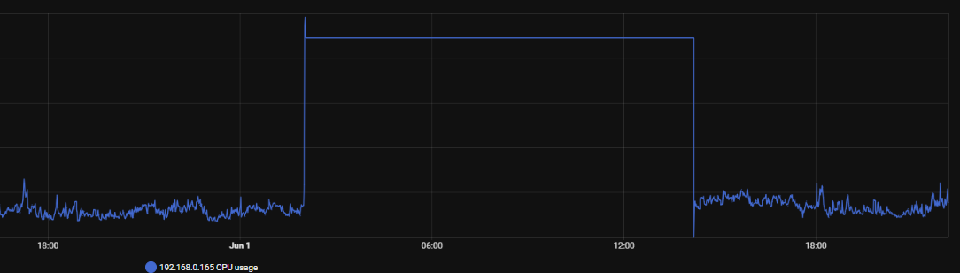

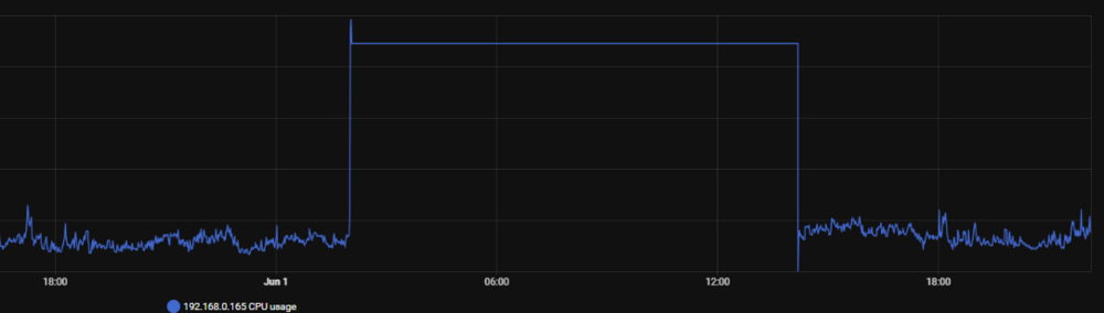

My system was unreachable again last night.
Are there any more configuration things that can be set?
I had to do a power cycle before it was reachable again.
Is there any way I can collect the system logs from before the power down?
I track my server power usage and stats like cpu usage in Home assistant and I can see that the usage spiked just before the system froze.
Maby there is a commen cause
skynet-diagnostics-20250601-2147.zip
