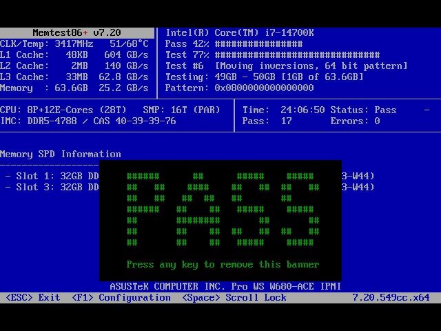

I updated my MB firmware to the latest stable in case there were any issues in the specific BIOS build first. Then I ran Memtest86+ for 24 hours (the one on the Unraid drive wouldn't run, so I grabbed the latest from their website and ran that.)

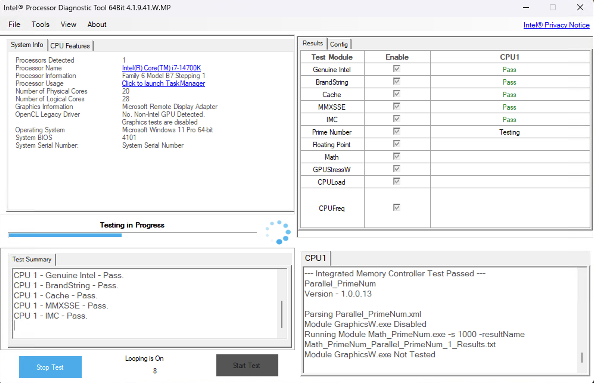

So, here's what I did to try and confirm it was a processor issue. I built a Windows 11 machine on a USB drive, and booted into that rather then Unraid. I installed the Intel Processor Diagnostic Tool (for anyone arriving here later and wanting to replicate, I tried installign that tool on Hiren's BootCD PE, but it wouldn't run and was forced to use Rufus to make a Windows 11 bootable USB drive.) I ran the 3 hour CPU burn-in test using this tool on a loop for 24 hours (closer to 30 hours if you ignore some interruption to update drivers before the straight 24 hour run.) I was hoping it would definitively lock-up on Windows doing this burn-in (100% processor usage with intermittent frequency and function checks) but sadly, it was rock solid and never crashed. As proof, here's a screenshot of the test running just past 24 hours.
So, that's frustrating. Absolutely no errors and rock solid operation on Windows for absolutely 24 hours of CPU thrashing.

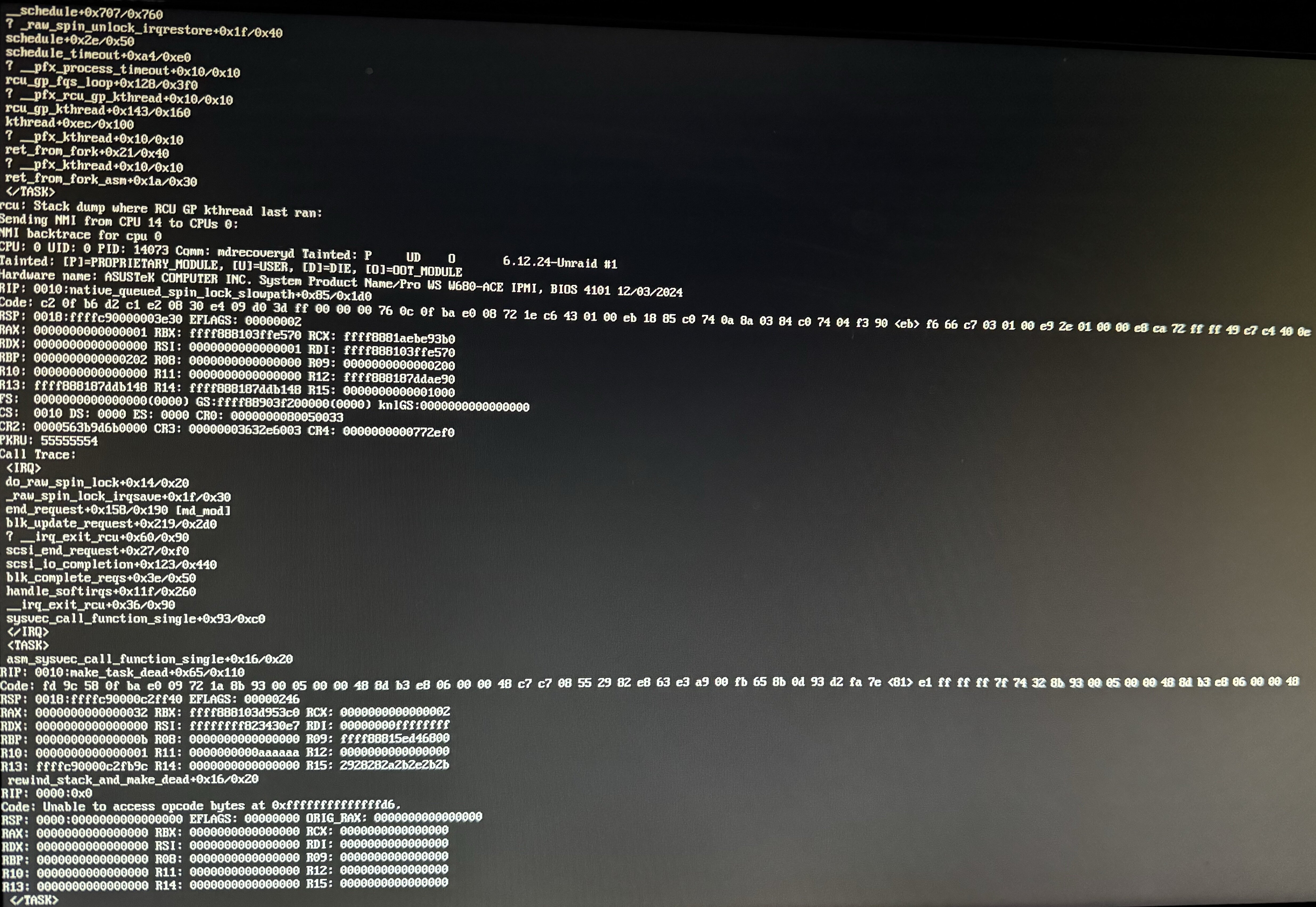

I shut that Windows USB drive down and returned to Unraid. And sure enough, just under 24 hours after booting up, it crashed again. But this time, I got a bit more data. In the past, I've never been able to see what was output on the console because of a GPU passthrough/dummy plug. The machine is headless other then the IPMI interface and that was always blank after booting into Unraid with the dummy plug. But this time, I left that off and hooked up a monitor to the iGPU interface. So this time, I captured what looks to me like a CPU crash dump? I'm not sure exactly what I'm looking at here, but it seems like processor register contents and stack contents from the CPU. Here's a literal photo (pardon the quality as this is an absolute cellphone photo since the IPMI interface couldn't catch it.)
This log repeats every 2-3 minutes and the machine is completely unresponsive otherwise. Does anyone have familiarity with this type of error? Is this my 13th/14th gen Intel processor Vmin shift smoking gun? Why would I experience this crash so repeatably on Unraid but not on Windows 11 after a much more strenuous CPU test? Inquiring minds (and frustrated admins) want to know.
