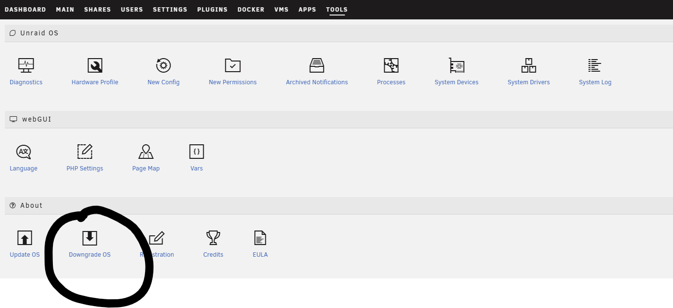

If that doesn't work and you don't mind, how to roll back?
On 5/26/2025 at 8:32 AM, MikeGNola said:
Got in, but the server is slow as molasses. dunno if it's doing stuff that slows it down. Will give it awhile.
Tools - about - downgrade OS
I finally found it, but decided to submit a ticket first. despite many tries have not been able to update plex. Imagine they are swamped with all the problems this update has given. Wil give them another couple of hours before rolling back.
Thanks again
Suggest still rolling back which is super quick and easy. There's bunch of strange and seemingly unrelated issues being reported this patch. If it works after rolling back... you can draw your own conclusion. In the worst case, it still does not work and you already have your ticket with Plex maintainer opened.
