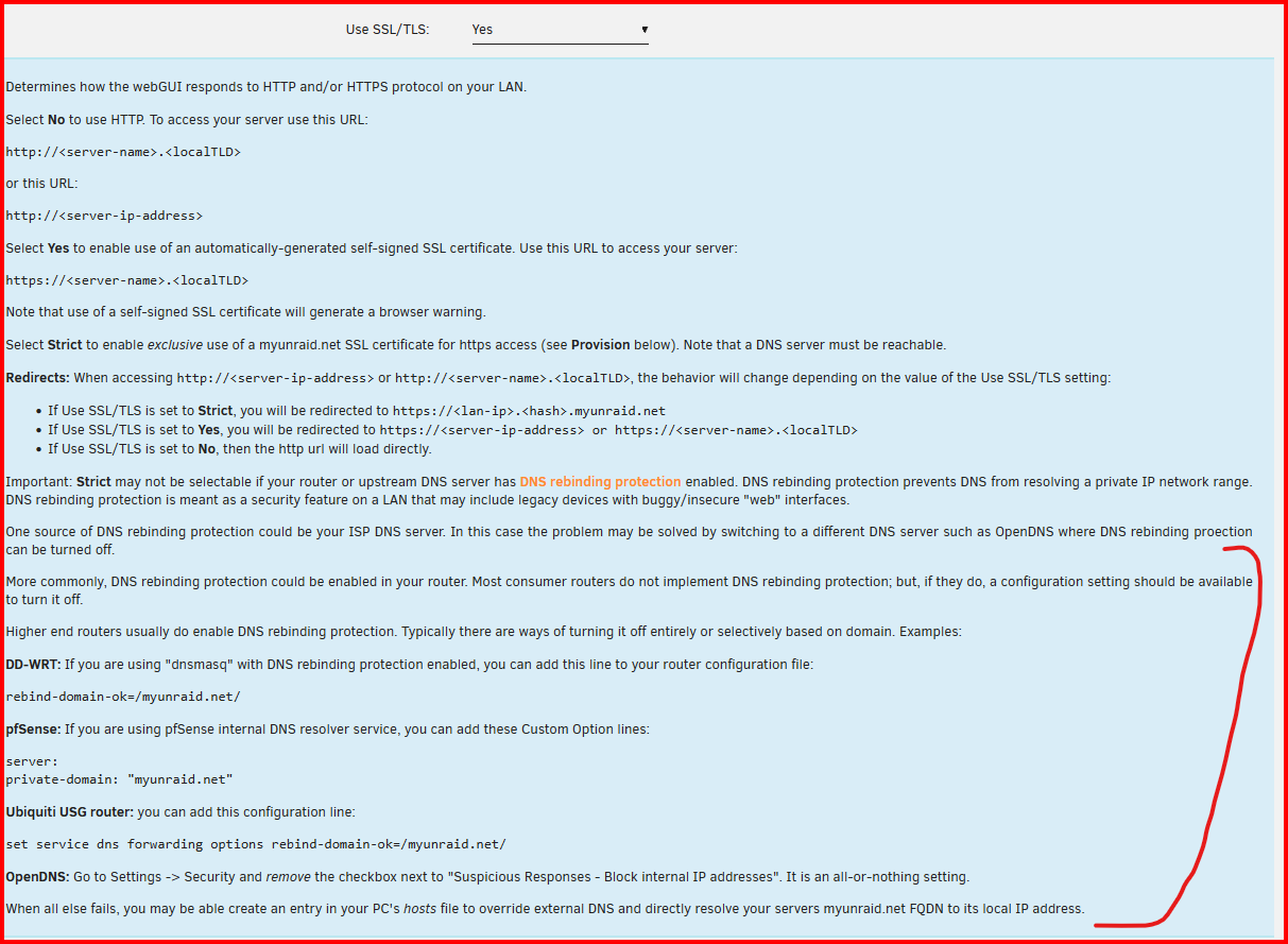

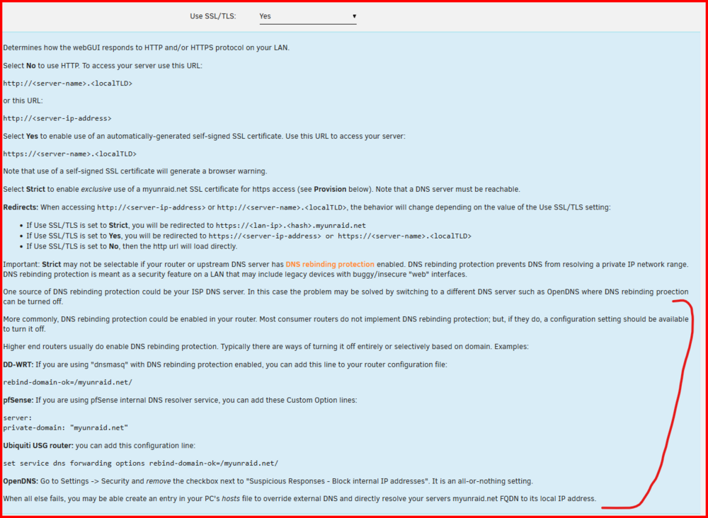

Make sure you are not getting bit by this one:
This is found under SETTINGS >>> Management Access
EDIT::: Also log into your router and see if it assigning an IP address to your Unraid Server.
Edited by Frank1940
Hi @Frank1940, thanks for coming back so quickly on this.
I've had a look into the DNS rebinding issue, but I've got Use SSL/TLS set to no, as I'm accessing the Unraid server via a reverse proxy (so it just works as http://10.10.10.66 and Nginx takes care of the SSL). I don't think this would have entered into it anyway though, since I was unable to access the Unraid server even via it's IP directly (without relying on DNS).
The router definitely assigns an IP address, I've just triple checked.
I was unable to access the Unraid server directly at it's IP (the IP set by the DHCP server on the router), or even to ping the IP.

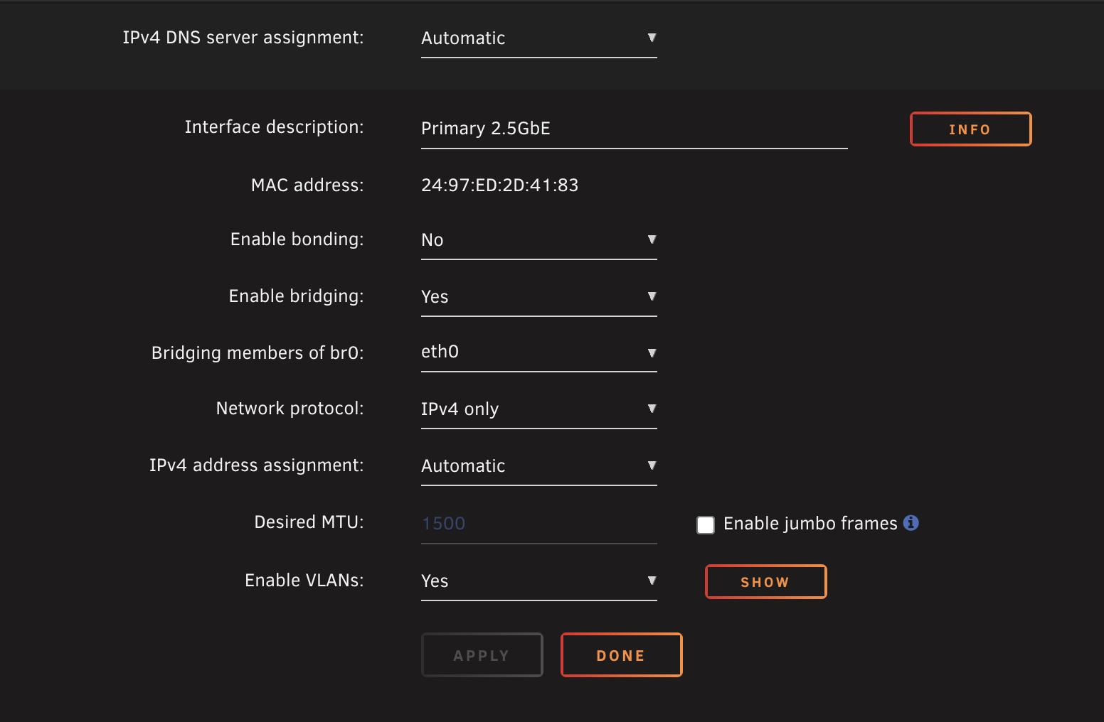

Hi, thanks for coming back on this @Veah
I've gone back to full DHCP (screenshot attached) and run ip addr to see what IP br0 was given:
host:~# ip addr show br0
7: br0: <BROADCAST,MULTICAST,UP,LOWER_UP> mtu 1500 qdisc noqueue state UP group default qlen 1000
    link/ether 24:97:ed:2d:41:83 brd ff:ff:ff:ff:ff:ff
    inet 10.10.90.66/24 brd 10.10.90.255 scope glo
Onice I did this I saw the same behaviour, where the local IP worked fine as a way to reach the Unraid UI for just a few seconds not long after reboot, and then it stopped working. The IP shown is the correct one that I have assigned to the NAS on the DHCP server. There's just the one nic on this device.
