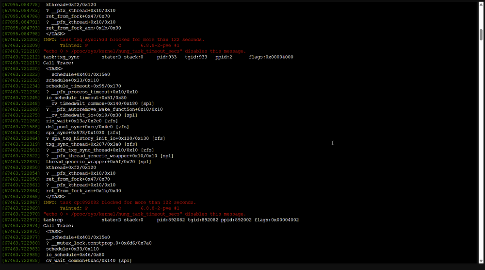

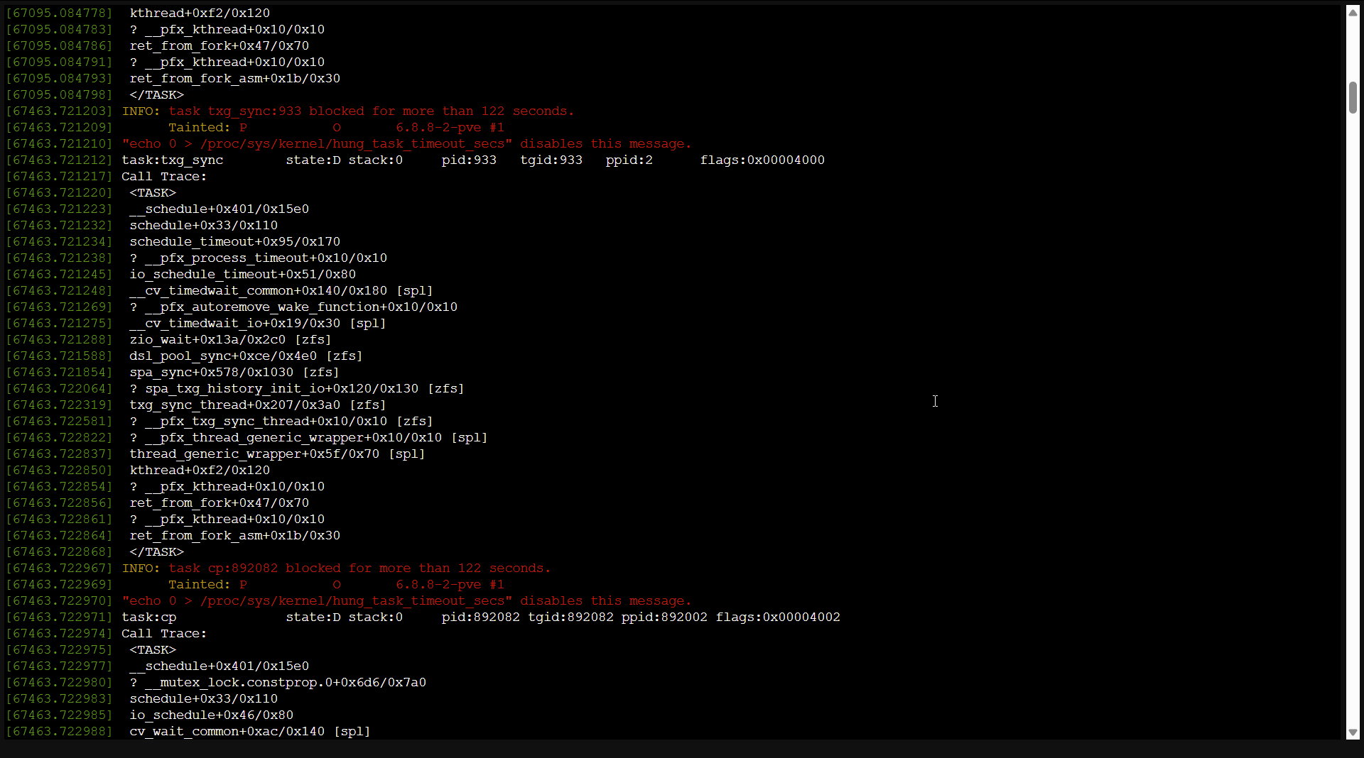

i also have a screenshot of the cpu hanging.

That crash is related to a zfs filesystem, though cannot say if it's the hardware issue causing the problem, or a bad zfs filesystem.

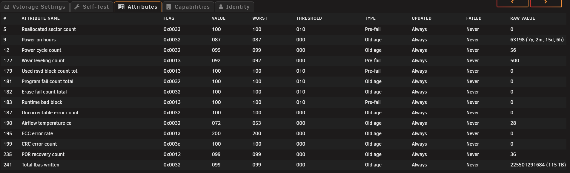

the disks in the ZFS pool are old used ssd's so could that be the issue ? even though smart readings are ok?
It should not be a device issue, could be a corrupt zfs filesystem, or bad hardware causing the issue, I would recommend backing up and recreating the pool, if it keeps crashing after that, there's likely another issue, like bad RAM
