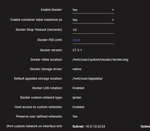

I tried this but didnt work still.
Still can't ping the Unraid server.
and vice vers ?
23 hours ago, alturismo said:
and vice vers ?
I can ping from unraid to the docker. i managed to fix it through just changed to Host.
